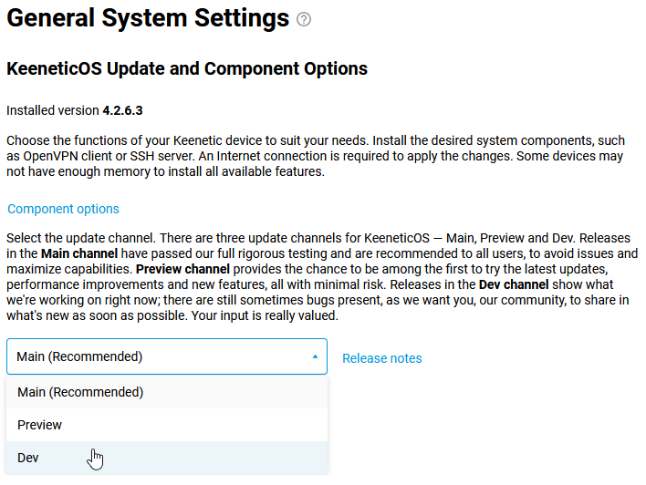

Go to the General System Settings page and select the update channel Dev.

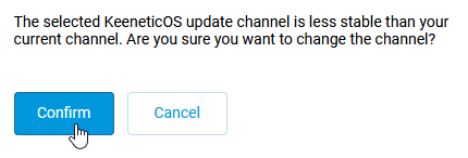

Confirm the channel change.

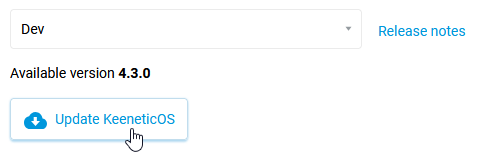

Then click Update KeeneticOS to update the router's built-in operating system.

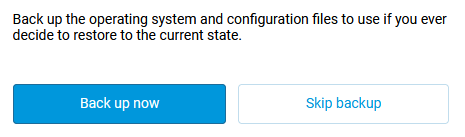

Next, a window will appear with a recommendation to save backup copies of the router operating system and settings. We recommend that you always perform a backup before updating the router software (saving the current settings startup-config file and firmware file with the current set of components), which will allow you to quickly restore the current state of the system if necessary.

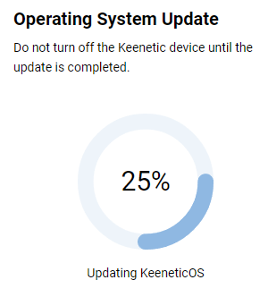

The KeeneticOS firmware update process will start.
Do not turn off the router until the upgrade process is completed.

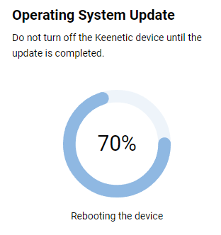

After the firmware update, the router will automatically reboot and be ready to work again.
To access the web interface, refresh the page in your web browser.
