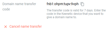

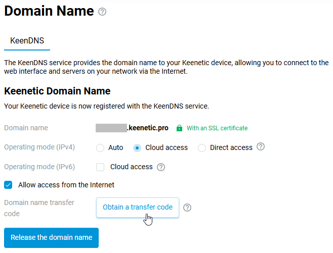

  2. On the 'Domain Name' page, the 'KeenDNS' tab click on the 'Obtain a transfer code' link. A domain name transfer code will be created. The code is valid for 7 days. Click on the link 'Copy to clipboard' and enter the received code in the Keenetic to which you want to give the domain name.

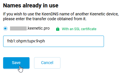

  3. On the second Keenetic, select the occupied domain name, paste the copied code into the appeared 'Transfer code' field and press 'Save'.
    The domain name will then be transferred to the second Keenetic router.
