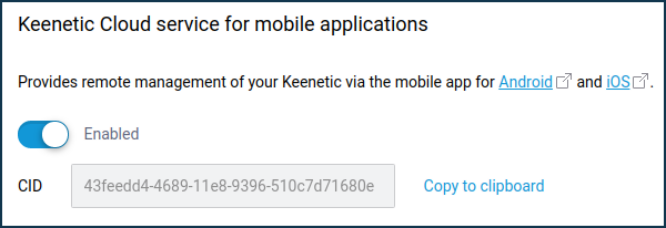

The Keenetic mobile application allows you to add a new Keenetic by CID (CloudID). You can find the CID of your Keenetic in the web interface, on the 'General System Settings' page, in the 'Keenetic Cloud Service' section.
Підказка
To avoid mistakes when entering a CID, copy it to the clipboard.

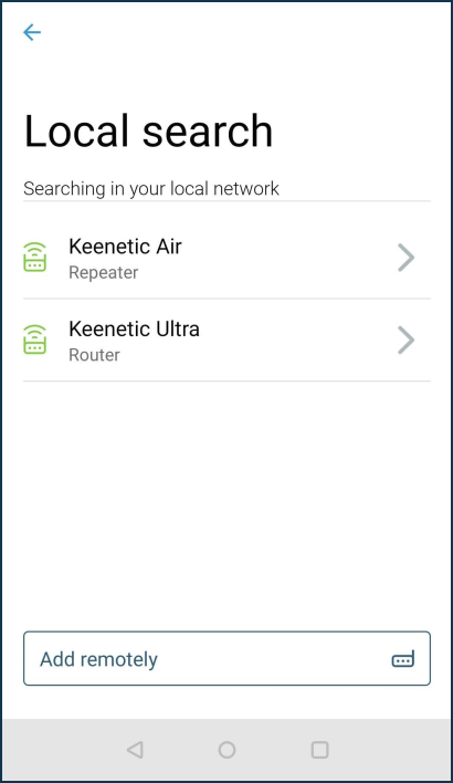

Start the Keenetic application and click 'Add Keenetic' on the Sites screen.
Before you start adding your Keenetic devices, make sure it is turned on and ready to use.
On the 'Local search' screen, click 'Add remotely'.

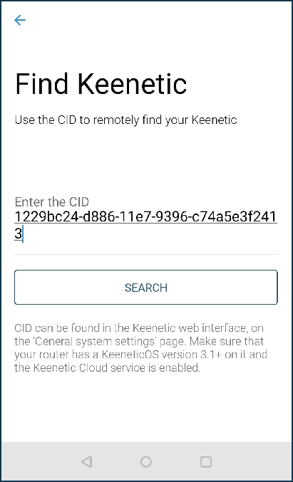

Enter the CID of your Keenetic or paste it from the clipboard and click 'Search'.

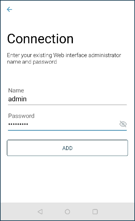

To connect to the Keenetic, use the same router administrator name and password as the web interface. Then click 'Add'.
On successful connection to the router, it will be added to the application.
