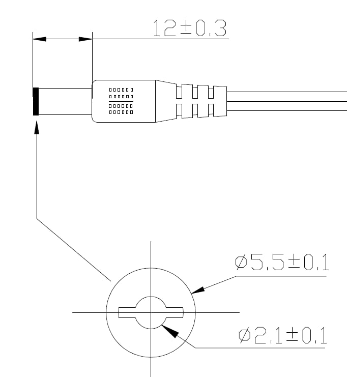

Keenetic routers (KN-xxxx) use the following supplied DC power adapters with following power jack geometry:
Router Model
Power Adapter
Keenetic Titan (KN-1811)
12 V, 2.5 A
All Keenetic models are powered from 100 - 240V 50/60Hz AC power.
The power adapters have a rectified stabilized output voltage of 9/12V with a DC current not exceeding 3.0A.
