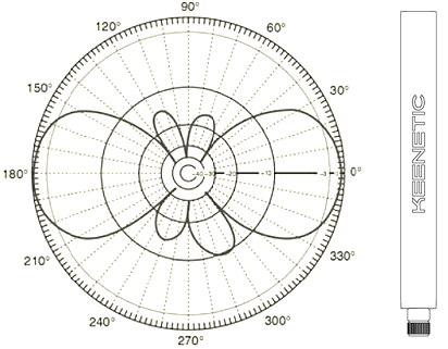

Directional diagram (vertical):

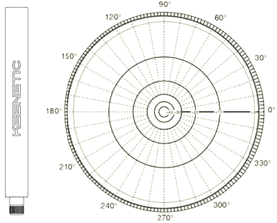

Directional diagram (horizontal):

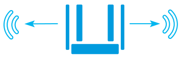

It is recommended for the best signal reception and transmission to place the Keenetic router's antenna vertically to spread the signal in a horizontal plane. Place the antennas vertically or with a slight vertical deflection towards the desired reception area.
In the horizontal plane (perpendicular to its own axis), the antenna will evenly emit the signal in all directions.
The antenna's vertical position on the router will transmit the signal horizontally over a more significant distance with maximum power.
