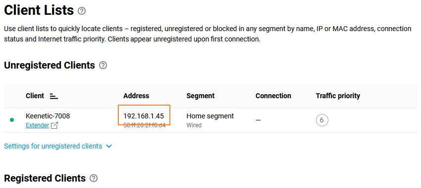

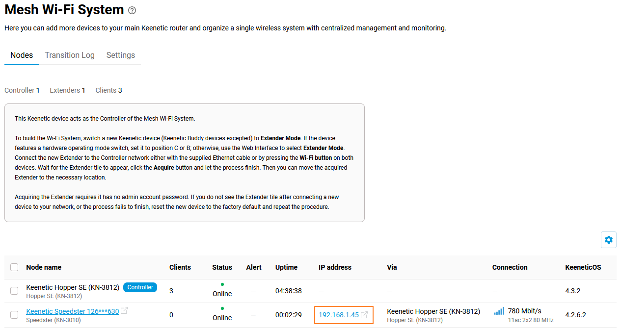

After switching to an additional mode, the web interface of your Keenetic will be available on a new IP address assigned by the main router and shown in the main router's web interface.
On the Keenetic router, you can view the IP address in the web configurator on the Client Lists page. For example:
If the extender has previously been captured in a Wi-Fi system, you can view the received IP address on the Mesh Wi-Fi System page. For example:
In our example, a Keenetic in the Extender Mode received an IP address 192.168.1.45 from the main router. This IP address will be used to access it from the local network. You can enter its web interface and make additional settings, for example, change the name of the Wi-Fi network or its channel.

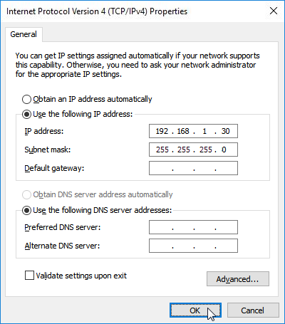

If the DHCP server is turned off on the main router of your network, you should use the static IP address 192.168.1.3. This is a temporary service IP address, which is preset in Keenetic in an additional mode just for those cases when you want to connect to the web interface, but the device didn't obtain an IP address in the network.
On a computer in the network connection settings, manually set the IP address to 192.168.1.4 ~ 192.168.1.254 with the mask 255.255.255.0 (in our example, we set the IP address to 192.168.1.30).
Then enter the IP address 192.168.1.3 in the address bar of your Internet browser to access the device's web interface.
If the above settings are made correctly, you will see the web interface of your Keenetic working in the additional mode.
After making the necessary settings in the web interface, revert the network adapter settings to obtain an IP address automatically.
