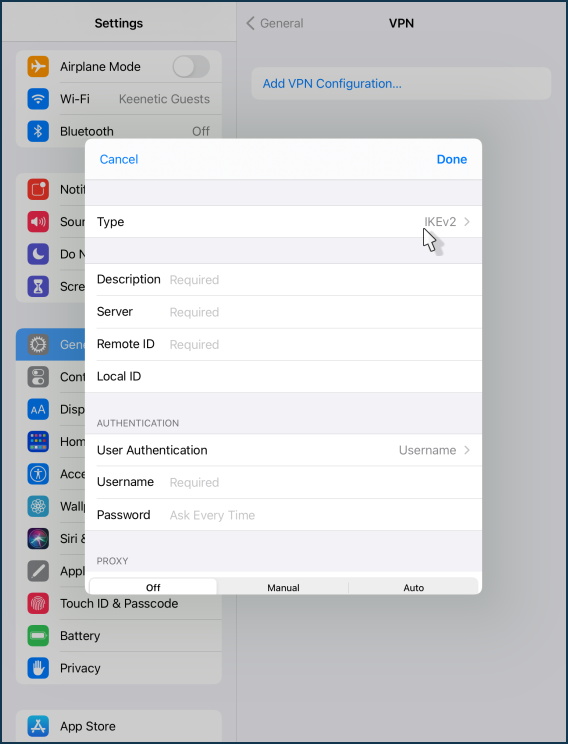

To connect to the server, create an L2TP/IPSec VPN connection on your iPhone/iPad.

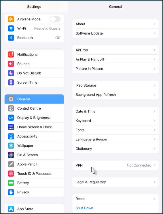

Go to 'Settings' in the 'General' section. Click on 'VPN'.

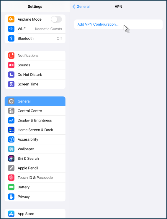

Click on 'Add VPN Configuration...'.

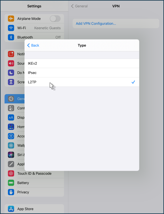

Click on the 'Type' field.
Select 'L2TP' connection type.

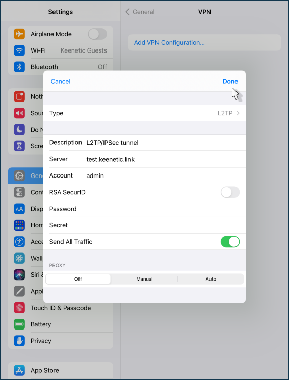

Then set up the VPN connection. Specify the 'Description', enter the domain name or public IP address of the Keenetic router. Specify the account that is authorized to access the VPN in the Keenetic settings and its password. Enter the 'Secret' that was set when the connection was created on the Keenetic VPN server. To save the settings, click 'Done' in the upper right corner of the screen.
These settings are enough to access the Keenetic home network.
By default, the 'Send All Traffic' option is enabled in the VPN settings. In this case, the iPhone/iPad will send all traffic to the VPN tunnel, including for Internet access via the Keenetic router.

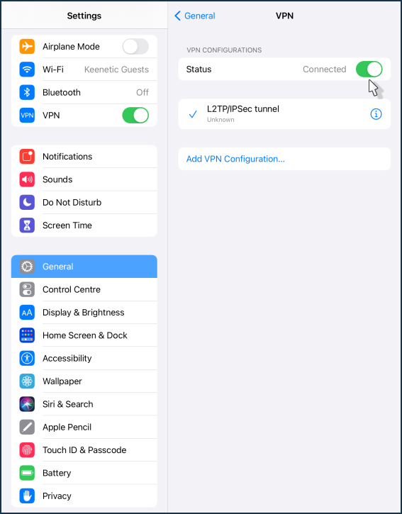

All that remains is to move the switch to the 'Connected' state.

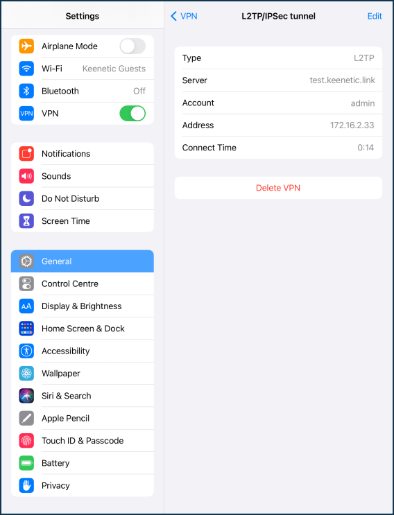

Once connected, click on the '(i)' icon to verify that the connection to the server has been established.
