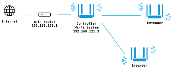

Imagine that an existing network has its main router with a DHCP server on it. Is it possible to connect Keenetic devices to this network and deploy a Keenetic Mesh Wi‑Fi System on it? In this case, you need the Wi-Fi System Controller to act as an ordinary Wi-Fi access point. Is it possible to use Keenetic in this way?
Although this connection scheme is not common, setting up such a topology is possible.
In a typical usage scenario, the Wi-Fi System Controller is the Main Router, the main gateway to the network. The Wi-Fi System Controller can only work on a Keenetic in the Router Mode. But technically, it is possible to use a third-party router as the main gateway, and on the Keenetic Controller in the 'Home segment' settings to turn off the DHCP server and connect its LAN port to the main router, assigning a free IP address from the subnet of the main router.

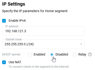

On the Controller, in the web interface, on the Home segment page, turn off the DHCP server and assign a free IP address from the subnet of the main router (in our example,
192.168.121.3
).There's no need to turn off NAT; it just will not be used because the router will not be using the external WAN interface.

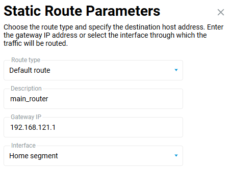

To allow the Controller to receive software updates, set the default route through the main network router and the DNS server address in the Controller network settings.
On the 'Routing' page, under 'User-defined routes', click 'Create route' and create a default route for the 'Home segment' interface by specifying the local IP address of the main router on the network as the gateway address (in our example it is
192.168.121.1

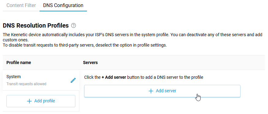

).On the 'Internet safety' page on the 'DNS Configuration' tab, click 'Add server' in the Servers section.
In the 'DNS server address' field, type in the IP address of the DNS server (in our example, it's a public DNS server from Google:
8.8.8.8

in the web interface.Connect the Controller and extenders to the main router's network and make sure that all extenders receive IP addresses from the main router's network.
On the Controller, acquire extenders into the Wi-Fi System.
If the above conditions are met, the software versions on the devices are the same, and there will be no problems with extender acquisition.
