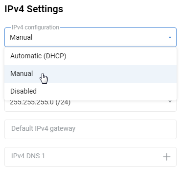

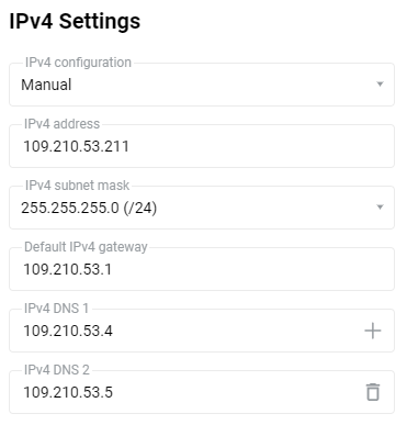

In some cases, however, your ISP would assign a static public IP address for you; it must then be specified in your router settings. To accomplish that, go to the 'Ethernet Cable Connections to Internet' page of Keenetic's web interface. In the 'IPv4 Settings' section, set the 'IPv4 configuration' to 'Manual'.
Then enter the address provided by your ISP in the 'IPv4 address' field.Your ISP must supply other IP parameters (subnet mask, gateway addresses, and DNS) along with a static IP address for manual configuration; please specify them in the appropriate fields. For example:
