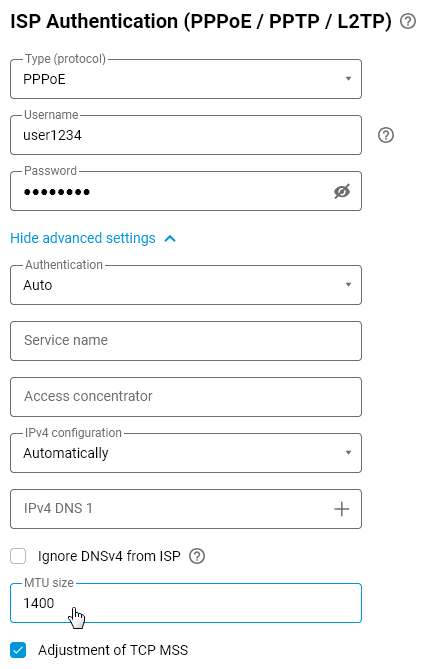

Setting the MTU size in Keenetic routers is possible via the web or command-line interfaces.
In the web interface, this setting is available on the Ethernet Cable Connections to Internet page in the IPv4 Settings section and the ISP Authentication (PPPoE / PPTP / L2TP) section if you are using a connection via the respective protocol.
In the IPv4 Settings section, in the MTU size field, you can specify the desired value between 64 and 1500. For a wired IPoE connection, the recommended MTU size is 1500.
In the section ISP authentication (PPPoE / PPTP / L2TP) click Show advanced settings. In the MTU size field, you can specify the desired value in the range from 64 to 1500. Ask your ISP for the recommended MTU value.

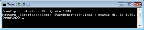

Also, you can use the command-line interface (CLI) of the router to set the MTU size. You should execute the following command to do it:
interface <interface_name> ip mtu <MTU_size>
For example, if you need to set the MTU = 1400 in the ISP interface (wired WAN interface to access the Internet), run the following command:
interface ISP ip mtu 1400
To save the settings to the non-volatile memory of the Keenetic device, be sure to execute the command:
system configuration save

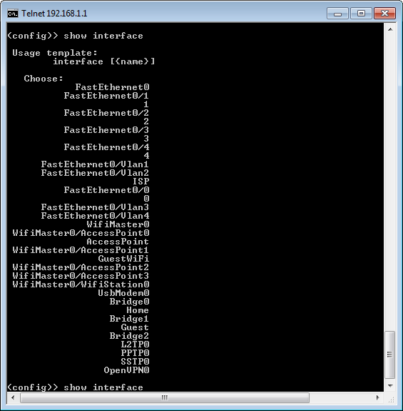

You can see the interface names of your Keenetic by running the command:
show interface
then press the Space bar and the Tab button.
Please note the interface names. You should always consider letter cases when using interface names in commands. For example, the interface names of ISP, PPTP0, L2TP0 should be specified only in capital letters, and the interfaces PPPoE0 or OpenVPN0 contain both capital and lowercase letters.
