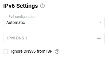

For simple IPoE access with a DHCP server, you only need to enable IPv6. You can do it on the 'Ethernet Cable Connections to Internet' page. In the 'IPv6 Settings' section, set the 'Automatic' or 'Manual' in the 'IPv6 configuration' field. Set to 'Disabled' to disable IPv6.

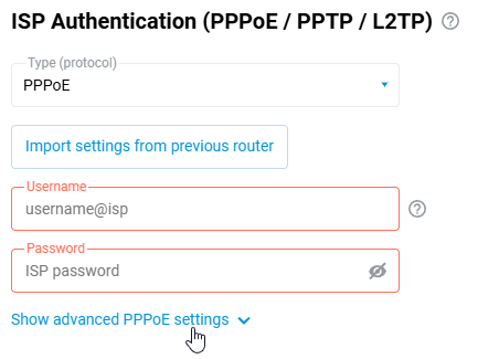

If you are using an authentication connection (PPPoE, PPTP or L2TP), go to the 'Ethernet Cable Connections to Internet' page and under 'ISP Authentication', click 'Show advanced settings'.
In the settings that appear, in the 'IPv6 configuration' field, set the 'Automatic' or 'Manual'.

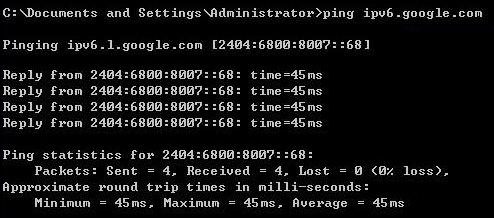

On your computer, check whether Internet resources will be available via IPv6.
For example, at the Windows command line, run the command:
ping ipv6.google.com
