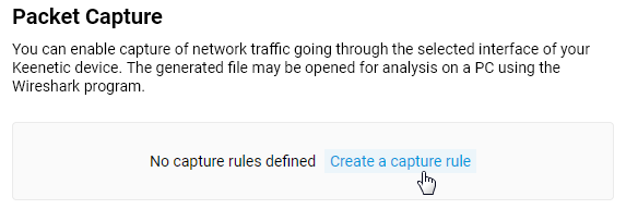

To capture network packets, go to the 'Diagnostics' page. In the 'Packet Capture' section, click 'Create a capture rule'.

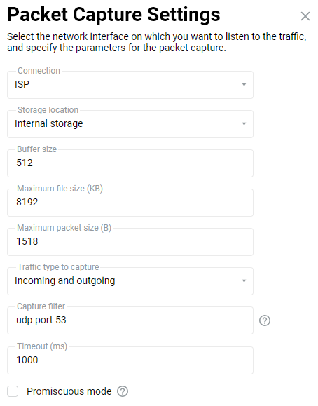

'Packet Capture Settings' window will open, where you must specify the 'Connection' (the interface from which you want to capture packets). In most cases, this is an active interface for connecting to the Internet — 'Provider' (ISP). If you use PPTP, L2TP, PPPoE or 3G/4G modem when connecting to the Internet, in these cases, specify the appropriate interface.
In some cases, traffic on the 'Home segment' interface may also be of interest.
It is impossible to capture packets between Wi-Fi-connected clients, as they are handled at the hardware level of the Wi-Fi chipset for maximum performance.
Specify the 'Storage location' of the packet capture file. If your Keenetic has a USB port for external drives, we recommend using it to save the file. Otherwise, the packet capture file will be stored in the internal memory of the device.
In the 'Traffic type to capture' field, you can select a value, depending on which traffic you want to capture — Incoming, Outgoing, or Incoming and outgoing (default).
If necessary, you can apply a filter in the 'Capture filter' field to reduce the amount of captured traffic and save memory space for the data you are interested in. The filter syntax is the same as in Wireshark. For example, with the filter 'host 192.168.1.33 and port 53', only DNS traffic from the host 192.168.1.33 will be captured. If nothing is specified in the 'Capture filter' field, all network packets will be captured, but in this case, the packet dump file will be larger in size.

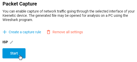

Click the 'Start' button to start the created rule.
The router will start collecting network packets.

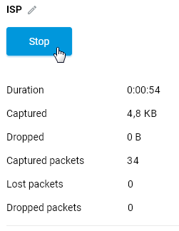

After the problem has been reproduced, you must stop capturing packets by clicking the 'Stop' button.
If a USB drive is specified in the 'Storage location' field, the network packet capture file will be saved to it. If the location is set to 'Internal Memory', click 'Save to computer'.
You will be prompted to save the file in the *.pcapng format, which contains the captured network packets.
