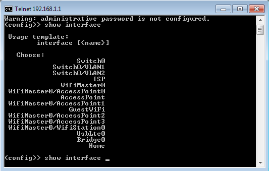

The list of interface names and their system identifiers can be viewed as follows: type the show interface command and then press the TAB key on your keyboard. You will see the list of all currently available interfaces of the device, including the preset service interfaces.

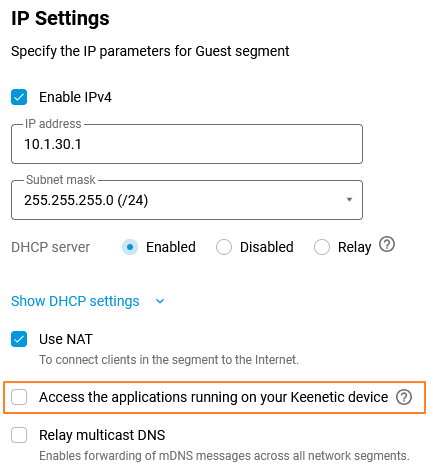

    The protected type is set for the Guest network Wi-Fi interface when the Access the applications running on your Keenetic device option is disabled in the web interface on the Guest segment page in the IP Settings section. By default, access to Keenetic is prohibited from the guest network. If you allow access to settings, this interface will be set to the private level.
