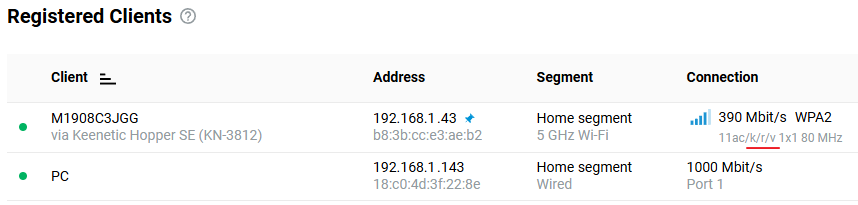

You can find out about 802.1r/k/v protocol support in the router's web interface on the 'Client Lists' page. When a Wi-Fi client is connected, the roaming standards that it supports are displayed. It is mandatory that 802.11k/r/v roaming features be enabled on the router side. Otherwise, they will not show up in the client device properties.
