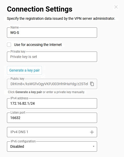

First, you need to configure the WireGuard server on the Keenetic device. The following instruction shows the process: Configuring a WireGuard VPN between two Keenetic routers. Then, move on to the VPN client setup.
If you want to configure a Keenetic router as a VPN server, make sure that it has a public IP address, and when using the KeenDNS service, that it works in the 'Direct access' mode. If any of these conditions are not met, connecting to such a server from the Internet will be impossible.

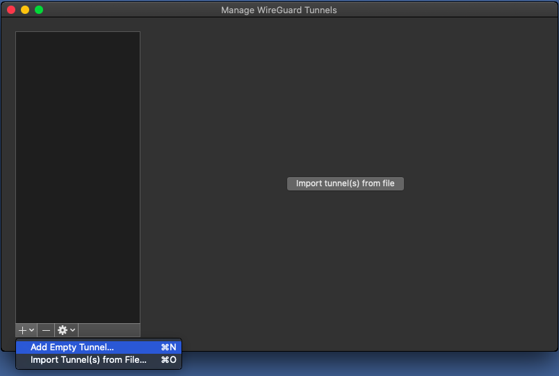

To connect to the Keenetic WireGuard server on a macOS-based computer, you need to download and install WireGuard.
  1. Launch the program and click on the down arrow in the lower-left corner. Select 'Add empty tunnel... [⌘+N]'.
  2. A connection setup window will open where you need to enter the Wireguard client settings for macOS [Interface] and the remote Wireguard server Keenetic [Peer].
    Leave this window open, do not close it.

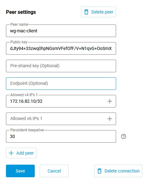

    Connect to the web interface of the Keenetic router and go to the InternetOther connections menu. Click on the previously created WireGuard connection (WG-S) and add Peer settings. Clicking on Add Peer will open the Peer Settings form, where you will enter the name of the tunnel wg-mac-client.
    In the Public Key field, insert the key generated earlier in step 2 of this article.
    In the Allowed v4 IPs field, specify the address from which traffic will be allowed to the server in IP/bitmask format — 172.16.82.10/32.
    In the Persistent keepalive field, specify the frequency of attempts to check the remote connection side's availability. Usually, a 10-15 second interval between checks is sufficient. By default, the Persistent keepalive value in peer settings is 30 seconds.
    Click Save.

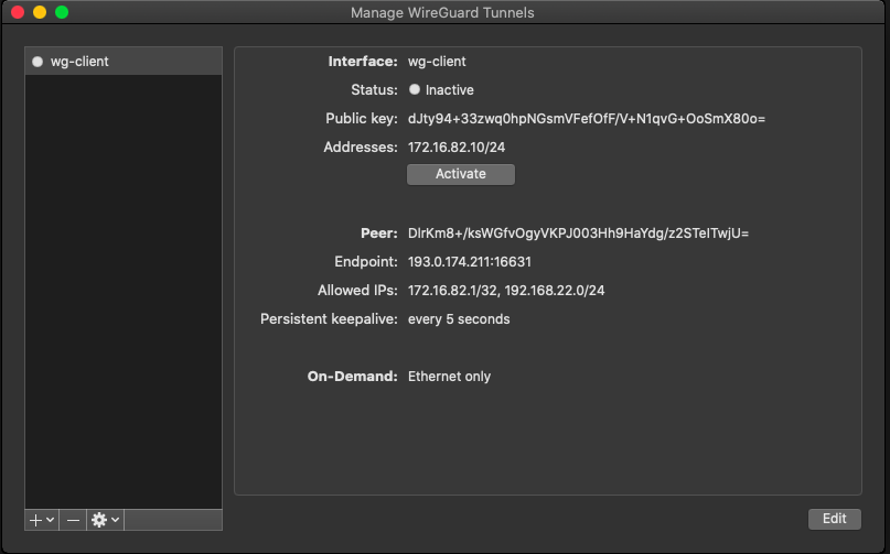

  4. Return to the Wireguard program settings; the configured connection will appear in the list.

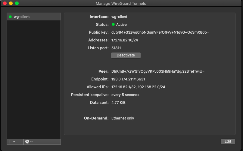

    Click Activate.
    If the setting is correct, you will see a green indicator in front of the Status line.

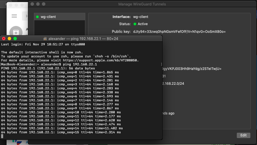

    To verify server availability, you can send ICMP packets to an IP address in Terminal.
    Check the availability of the server web interface (in our example, it is a Keenetic with IP address 192.168.22.1).
    The setup is complete.
