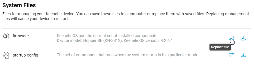

To update the KeeneticOS, go to the 'General System Settings' page. In the 'System Files' section, in the file line of the 'firmware', click on ‘Replace file’ icon.
In the appeared window, specify the system file's location for your device (file with the extension 'bin

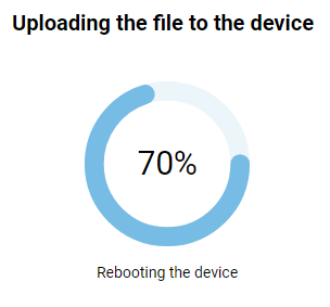

The system file will be uploaded to the Keenetic router.
Do not turn off
the power during the update process!

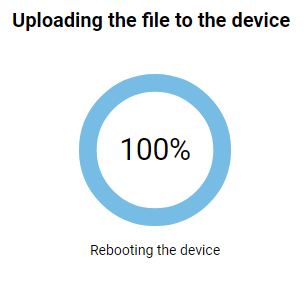

When the update process is complete, your Keenetic will restart automatically and then be ready for use again. The web interface will be unavailable for approximately 2 minutes
Then, on the 'System dashboard' page, make sure that the OS version has changed. It is shown in the 'About the system' information panel in the 'OS version' line.
