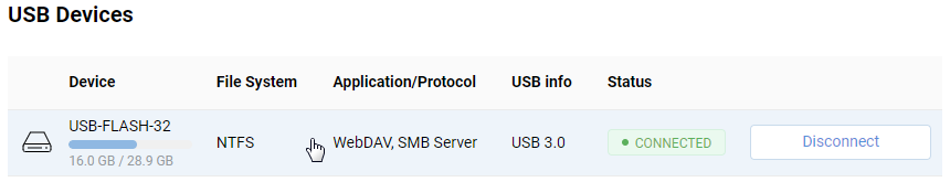

At first, connect a USB drive to the Keenetic as follows: Connecting a USB drive.

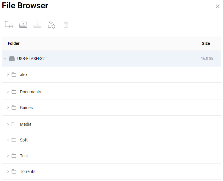

    Use the KeenDNS registered domain name to connect to the Keenetic web interface. Once connected, go to the 'Applications' page and click on the connected disk entry.
    The built-in file manager will appear, where you will see all folders on the disk.
    With the built-in file manager, you can:
    • create-folder-sign.png Create a directory inside the selection;
    • download-sign.png Download a file to your computer;
    • upload-sign.png Upload a file to the selected directory;
    • delete-sign.png Delete a file or folder.

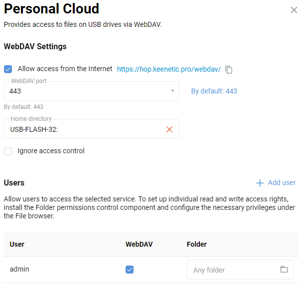

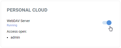

    To set up the WebDAV server on a Keenetic router, go to the 'Applications' menu. In the 'Private Cloud' section, turn on the 'Allow access from the Internet' option. In the 'Users' subsection, enable the 'WebDAV' option for the user you want to allow remote access and then click on 'Folder' field to specify the desired folder on the USB drive.
    Be sure to check the permissions for the parent folder. In the built-in file manager window, click on the parent folder, then on the permission-sign.png button and assign 'Read-only' or 'Read & Write' access rights.
    Now go back to the 'Applications' page. By default, the WebDAV server is disabled. To enable the server, move the switch to the 'Enabled' state.

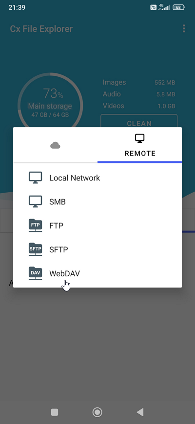

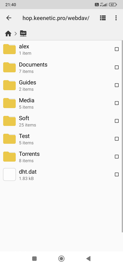

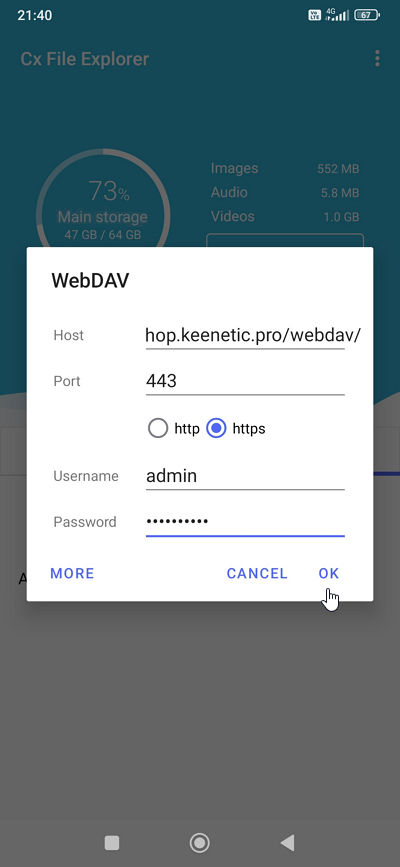

    Next, you need to establish a remote connection to the WebDAV server. This can be done through a web browser or a file manager that supports the WebDAV protocol. The choice of software depends on the operating system and the type of device (mobile device or desktop PC) from which the connection will be made. We recommend using a file manager so that you can delete, move or add a file to the USB drive. If you only need access to files, use the easiest and most accessible option, your Internet browser. Examples are shown in the Connecting to a USB drive with WebDAV instructions.

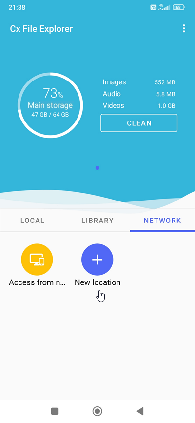

    For example, access via WebDAV from an Android mobile device:

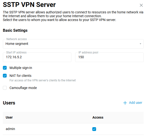

    You can set up an SSTP VPN server or OpenConnect VPN server in your Keenetic router. It allows the remote connection of clients to your local network.
    The main advantage of the SSTP (Secure Socket Tunnel Protocol) and OpenConnect tunnels is its ability to work through the cloud, i.e. it allows you to establish a connection between the client and the server, even if there are private IP addresses on both sides. All other VPN servers require a public IP address.
    We will show an example with an SSTP VPN server, but similarly you can use an OpenConnect VPN server.
    Configure the SSTP server according to the instruction SSTP VPN server. For example:

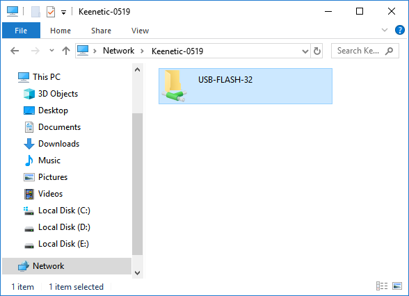

    After successfully connecting to the SSTP VPN server, set up network access to a USB drive connected to the Keenetic. For example, on Windows, launch the 'Run' application or the 'Explorer'. In the address bar, enter the local IP address of the Keenetic after '\\' symbols (in our example it is \\192.168.1.1).
    If 'Anonymous Access' is turned off when you set up USB sharing on the 'Windows Network' page, you will be prompted to enter your login and password. In this case, you need to specify the account information to access your Windows home network and USB drives via SMB/CIFS protocol.
