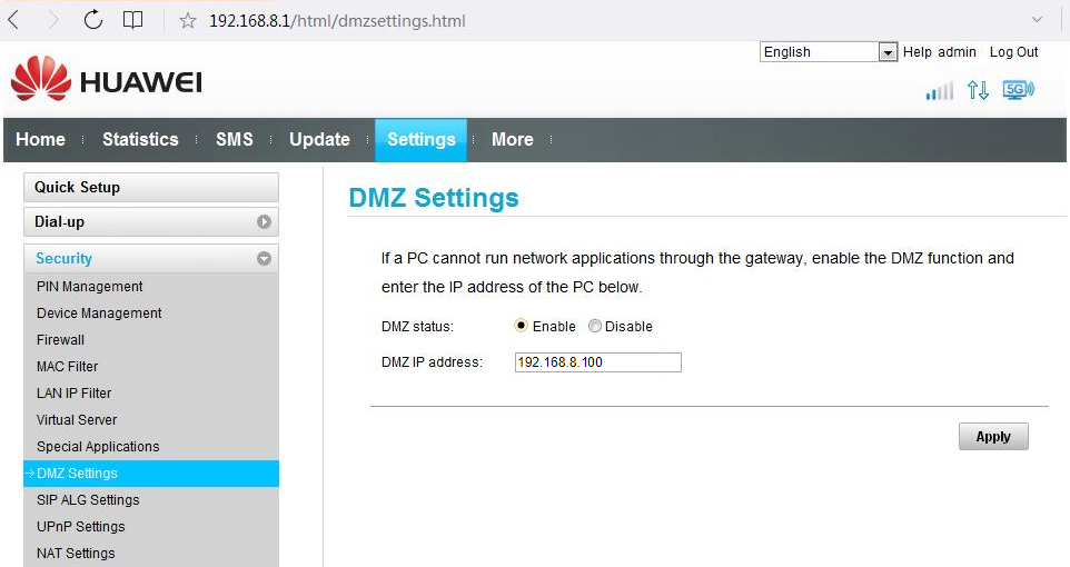

Some USB modems (e.g. in CDC Ethernet mode) operate as routers with NAT and assign their LAN address as the default gateway to the Keenetic router. Even if your operator provides a public IP address, you must still enable the DMZ function in the USB modem settings.
Let's see how to do it using the example of a Huawei modem with HiLink firmware. In the modem web interface (available at 192.168.8.1) in the DMZ Settings section, you need to enable the DMZ function (forwarding of all ports) and specify the address that the Keenetic receives from the modem as the DMZ IP address (in our example, it is 192.168.8.100). It looks like this:

If it is possible to reserve this DMZ address (assigned to the router) in the modem's DHCP settings, then do so.
If the USB modem web interface does not have a DMZ setting, you need to re-flash the modem with software with unlocked DMZ/NAT functions or change it to one with these functions.

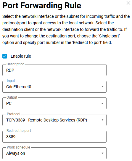

Now, proceed to configuring port forwarding on the Keenetic router. Connect to the Веб-інтерфейс and go to the Port Forwarding page. Add a port forwarding rule. In the Input field, choose the USB modem interface, and in the Output field, specify the device to which the ports will be forwarded. For more information, refer to the Port forwarding instructions.
