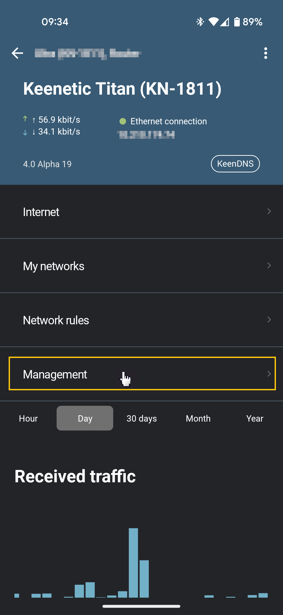

On the site dashboard, select the device whose settings you wish to connect to and then click on its name:

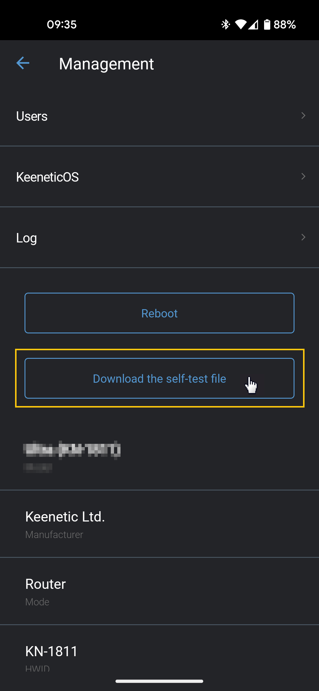

Go to 'Management':
Click on the 'Download the self-test file' button:
This will download the self-test.txt
file from the router to your mobile device.
You can now send the saved file to Technical support by post.
