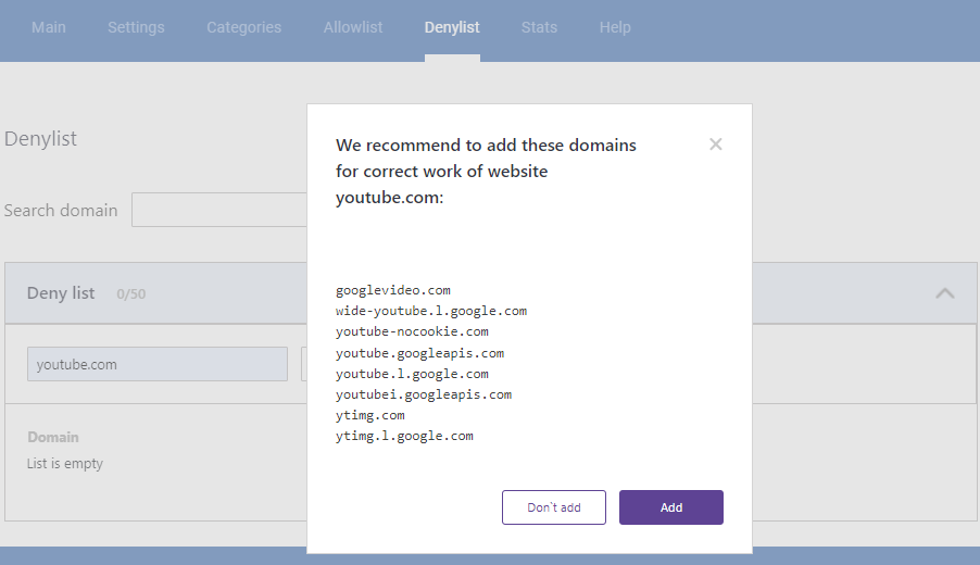

Here's an example of how to block youtube.com
. To do this, we'll blacklist Youtube, and the service will automatically suggest adding additional domains that are recommended to accept for complex blocking.

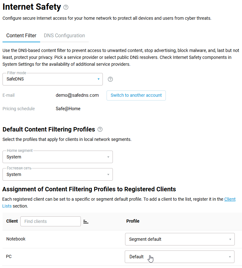

Then, in the router's web interface, turn on the SafeDNS filter on the 'Internet Safety' page and set the 'Default' profile for the specific device. Depending on the task, the SafeDNS filter can also be applied to all registered and unregistered devices.
After setting this, we recommend that you restart your router and then check access to the blocked site.

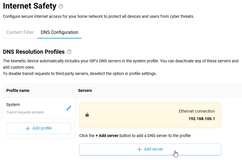

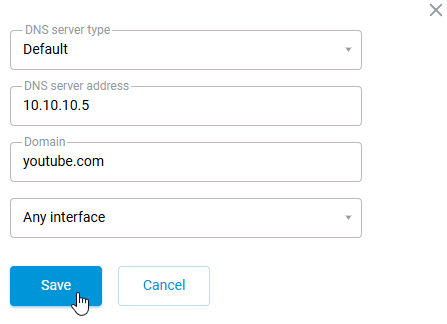

Blocking on the router. This method has a peculiarity — it will allow you to block access of all hosts in the local network to the specified site. It can not be used for a particular host.

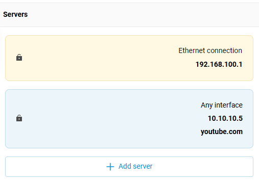

The configuration is done from the router's web interface. Go to the 'Internet Safety' menu to the 'DNS Configuration' tab. Click 'Add server'.
In the 'DNS server address' field, you must enter any non-existent (free, unused) IP address from the private address range. It can be an IP address from another subnet, different from the Internet centre network. In our example, when requesting the youtube.com
site, the host will be given a non-existent address, 10.10.10.5

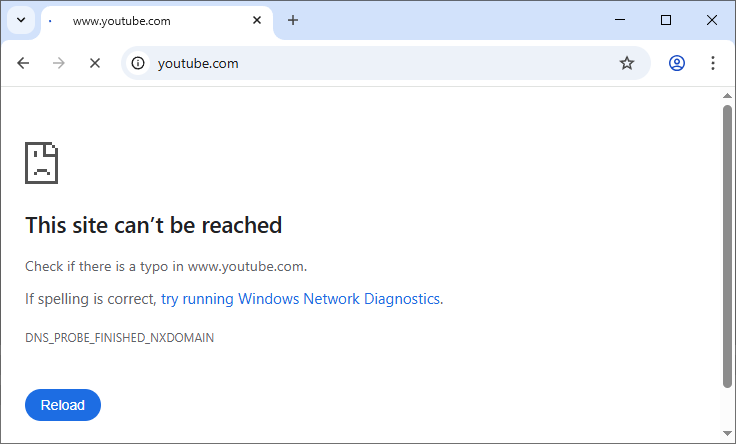

, and therefore, the page will not open.
After this settings, check access to the blocked site.
Created static DNS records have higher priority over Internet filters.

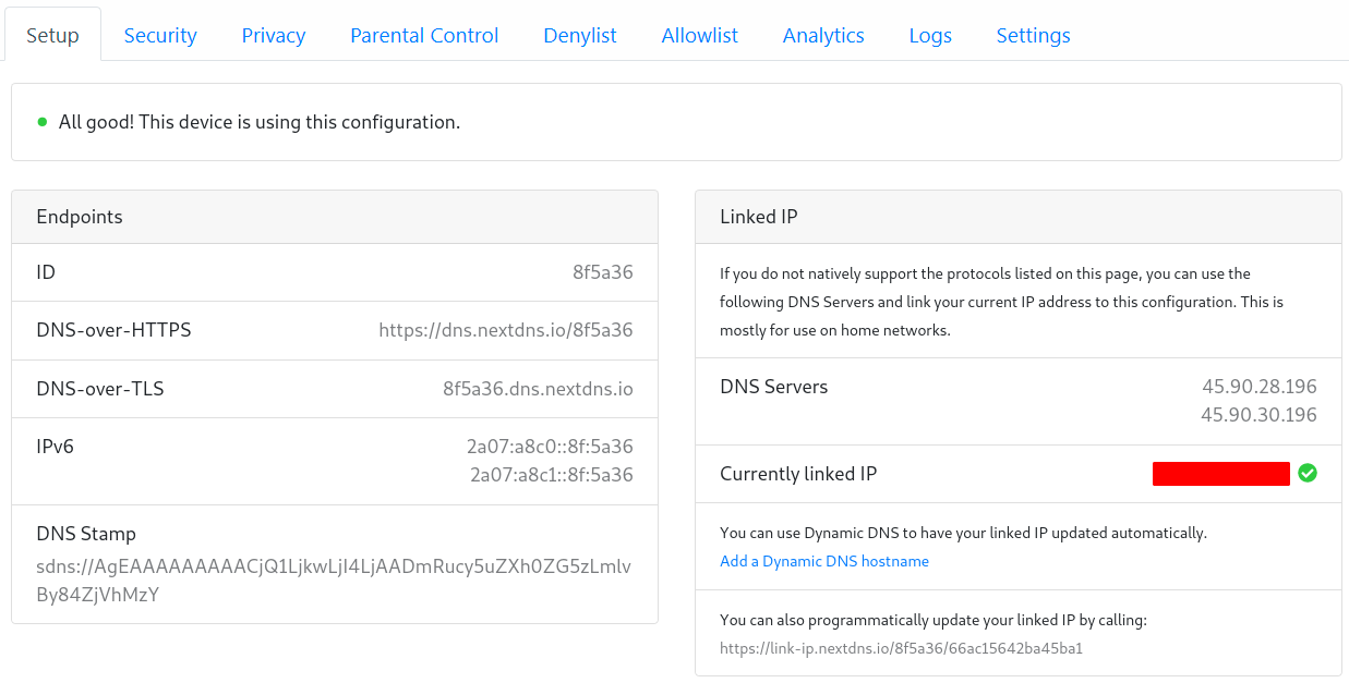

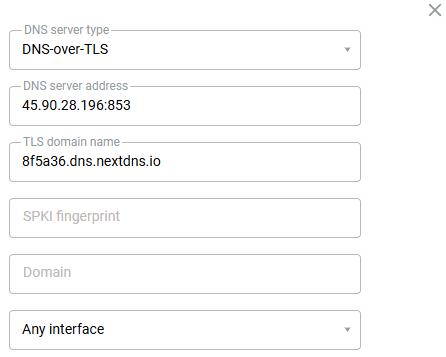

Method of blocking a site using NextDNS service.
NextDNS supports 'Denylist' and 'Allowlist' access lists. At the time of publication of this article it was free of charge if the number of DNS queries is less than 300 thousand per month: https://nextdns.io/pricing

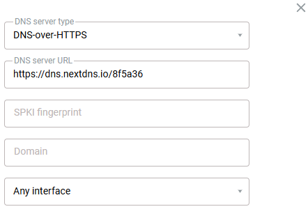

To use it, form an address profile:
Add the specified DoT (DNS-over-TLS) and DoH (DNS-over-HTTPS) server addresses to the 'Internet Safety' page of the web interface:
You can read more about this in the article 'DoT and DoH proxy servers for DNS requests encryption'.

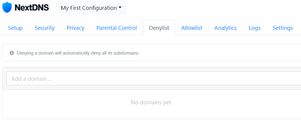

After that you can add the names of blocked sites in the Denylist section:

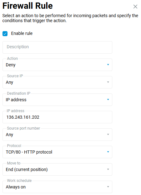

For instance, let's block access to the google.com
site for all LAN devices using firewall rules.

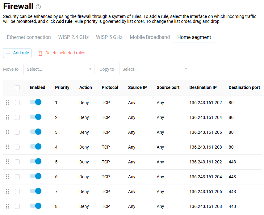

Domain names cannot be used in the Keenetic firewall settings (you cannot specify a domain or site character name), but only IP addresses. Therefore, you need to determine the IP address(es) of the website you want to block before configuring the rules. A website may have multiple IP addresses, in which case you must block access to all IP addresses. Websites can also operate not only with HTTP but also with HTTPS. We recommend blocking traffic to the site using both protocols.

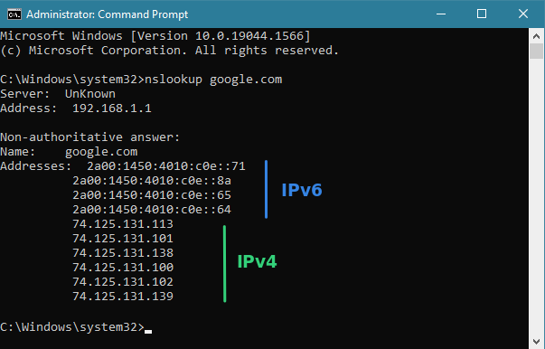

The first way to know the IP address of the site is to use a special command in the command line of the operating system:
nslookup <website_name>
In our example, we will run the command nslookup google.com
The result of the above command will show the IP addresses where the website is located.

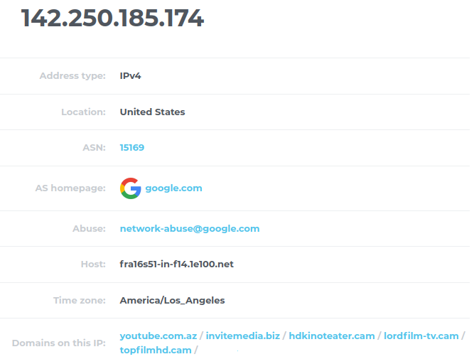

The second way to find out the site's IP address is to use one of the special online services (for example, 2ip.io). In a special line, you will need to specify the site's name you are interested in and press the 'Check' button. After that, you will see all the IP addresses where the site works. For example:
Now that you know the IP addresses of the website, you can start creating firewall rules.
In this example, the site uses 4
IP addresses, so let's create 8
rules for the 'Home segment' LAN interface to block traffic by protocols: 4
for HTTP and 4
for HTTPS.
Create a 'Deny' rule where we specify the destination IP address (the site's IP address to be denied access to) and the protocol type (HTTP and HTTPS). We are blocking access to the site for all devices on the local network, but if you need to deny access only to a particular host, specify its IP address in the 'Source IP' field when creating the rule.
After creating the rules, test access to the site.
This method is not always convenient. For example, to block Skype at the network level, you need to know all the IP addresses it uses. Finding them all and keeping your list up to date is a challenge. Many websites also use several different addresses to download their data to increase productivity.
