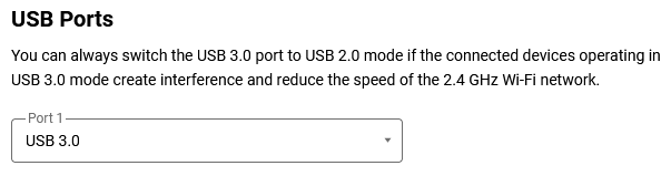

If you select the USB 3.0 operation mode in the web interface, you can see the following message:
USB 3.0 connected devices may interfere with the 2.4 GHz Wi-Fi network. If you encounter such a situation, disconnect the connected device from the router and verify the wireless network operation in the 2.4 GHz band.

  4. Use USB 2.0 to connect additional devices to the router
    Connect the device (modem, external hard drive, printer) to the USB 2.0 port of the router or set the USB 3.0 port to USB 2.0.
