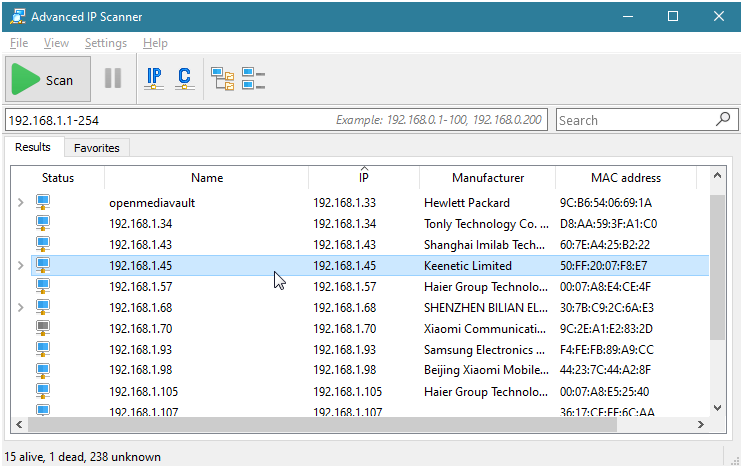

If you don't have access to the web interface of the main router, you can find the IP address of Keenetic using any app that scans and identifies devices connected to your local network. There is a wide range of such applications for both PCs and mobile devices. We will show you an example of the Advanced IP Scanner application on PC.
Install the app on your home computer. Connect the computer to the main router's network via wire or Wi-Fi.

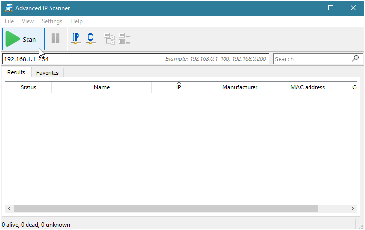

Launch the app and press the Scan button to search for local network devices.
After performing a local IP range scan, the application will show the detected active network devices in the Results tab. For Keenetic, the Manufacturer column will show Keenetic Limited, and the IP column will show the router's local address on the network. In our example, Keenetic has an IP address of 192.168.1.45.

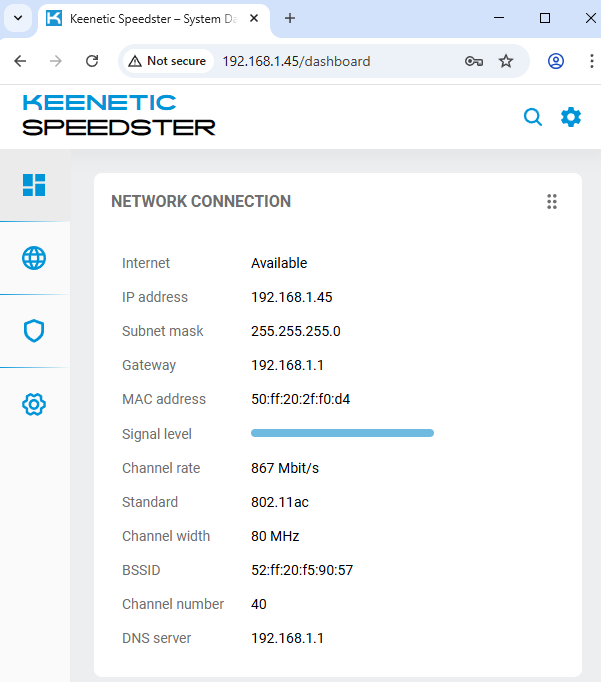

Now connect from your browser to the web interface using the IP address of the extender.
