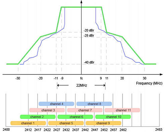

In the 2.4 GHz band, 13 channels (11 channels in some countries) are available for wireless networks, with 5 MHz spacing between channels. Wireless 802.11b/g devices use 20 MHz channels for signal transmission. An 802.11b/g wireless device uses one of the 13 channels from the 20 MHz band within the 2.4 GHz frequency but actually uses 5 overlapping channels.
For example, if an access point uses channel 6, it interferes significantly with channels 5 and 7 and interferes with channels 4 and 8. When the device transmits data, the wireless signal deviates from the centre frequency of the channel +/- 11 MHz. There is a deviation of up to 30 MHz of radiofrequency energy from the central channel in some cases. To eliminate mutual interference between channels, their bands must be separated from each other at least by 25 MHz. This leaves only 3 non-intersecting channels on the 20 MHz band: 1, 6 и 11. With a channel width of 40 MHz channels 3 and 11 are non-intersecting.
Wireless access points operating in the 2.4 GHz band within the same service area must avoid channel overlap to ensure wireless network quality.
