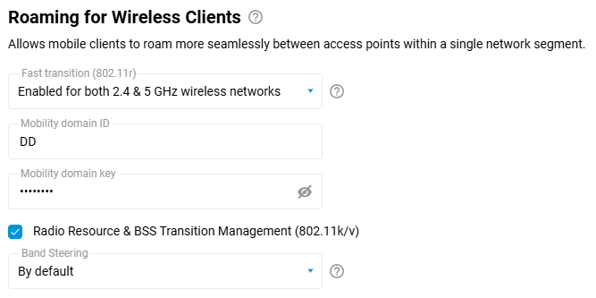

You can make Seamless roaming (802.11k/r/v) settings in Keenetic's web interface on the 'My Networks and Wi-Fi' page in the 'Roaming for Wireless Clients" section. But first, you should add at least one Wi-Fi network to the segment. Fast Transition (802.11r) will work in networks protected by WPA2/WPA3. In a dual-band device (2.4 and 5 GHz), to unlock 802.11r, you must have only one W-Fi network or SSID; passwords and work schedule should be the same for both ranges.
Choose one of the following items in the 'Fast transition (802.11r)' list: 'Enabled for both 2.4 & 5 GHz wireless networks', 'Enabled for 2.4 GHz wireless network only', 'Enabled for 5 GHz wireless network only' or 'Disabled'.
When you enable 802.11r, type the 'Mobility domain ID' and 'Mobility domain key'. The corresponding values of these parameters should be the same on all routers of the local network.
Turn on 'Radio Resource & BSS Transition Management (802.11k/v)'. It will allow the client to transmit information about neighbouring access points and their signal levels.

The optimal settings for seamless Wi-Fi roaming are as follows: Enable 802.11r for the 2.4 & 5 GHz bands, 802.11kv and set Band Steering to 'Prefer 5 GHz'. In exceptionally rare cases, a client device may not connect to the router's network. For details, see the article 'Why can't my device connect to Wi-Fi when my router has Fast Transition (802.11r) enabled?'
