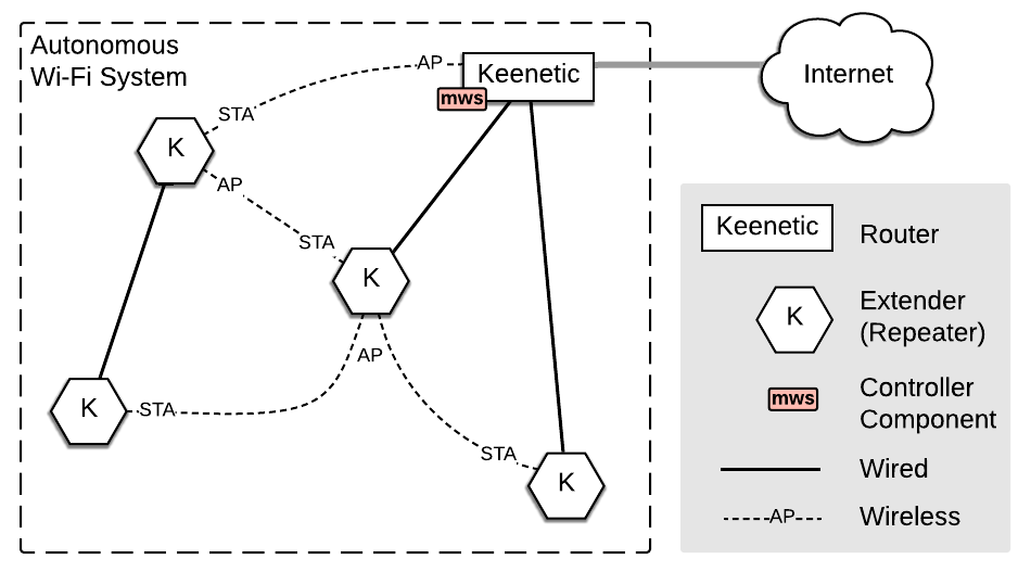

It is possible to connect an extender simultaneously over an Ethernet cable and a Wi-Fi network. In this case, the cable connection will take priority. If the cable is disconnected or the link to the controller is lost, the extender will establish a Wi-Fi connection (this switching takes about one minute). For switching to take place, the controller must have the wireless backhaul connection enabled.

All nodes operating in Repeater/Extender Mode and acquired by the Wi-Fi Controller automatically configure the WifiMaster1/WifiStation0 interface to connect to a hidden SSID. This backhaul link uses the 4-address format of Wi-Fi headers, similar to WDS, containing Receiver's Address [RA], Transmitter's Address [TA], Source Address [SA] and Destination Address [DA], i.e., addresses of intermediate wireless nodes and LAN endpoints.
Home, Guest and other segments are multiplexed in wireless connections just like they are in wired connections — using VLAN 802.1q.
In each segment, the STP protocol is enabled to provide optimal link selection between extenders. Preference is given to wire connections. When an extender is connected via wire, a wireless connection is still established. Still, data transmission over the STA interface is blocked at the bridge level as long as the cable is connected.
When switched on, the extender selects the optimal access point based on its signal strength and the metric (distance to the controller) transmitted in the Probe response packet. The metric is calculated from the root_path_cost STP value. In this way, the wireless extender can detect if the access point is connected to the controller and how far it is. The controller itself transmits a metric equal to one.
