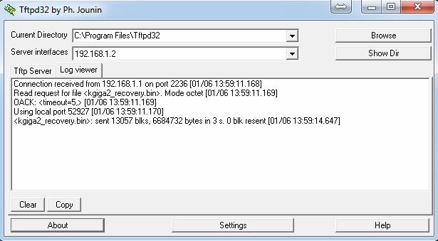

  3. Download and install a TFTP server such as tftpd32 on your computer.
    Put the firmware file (bin file) for your model in the installed TFTP server's folder (the default folder is C:\Program Files\Tftpd32).
    Run the TFTP server.

    Keenetic should get the file with the firmware from the TFTP server and write it into the non-volatile memory.
  7. In about 5–7 minutes, the device will reboot and be ready to work with the new firmware.
