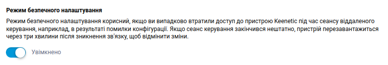

By default, the Fail-safe mode is disabled. When the Fail-safe configuration mode is disabled, the system records any configuration changes made via the Web Interface into the startup configuration immediately when you click the Save button.
To operate in fail-safe mode, navigate to the 'Fail-safe configuration mode' section of the 'General System Settings' page in your Keenetic's web interface, and enable this mode.

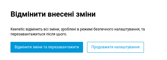

If you want to revert the applied configuration, click the Rollback button on the Fail-safe configuration prompt. The confirmation dialogue will appear, allowing you to reboot the device to roll back the changes or to continue editing the settings.
