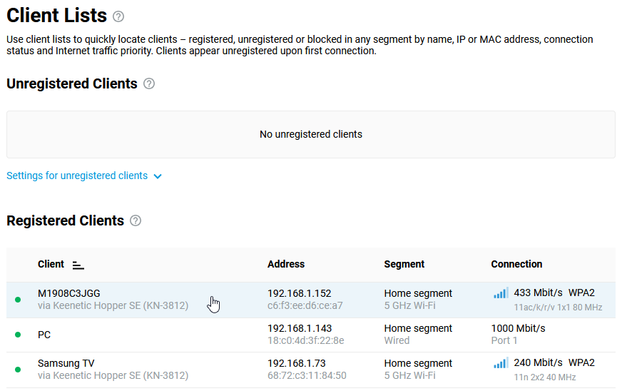

  1. First, register all devices on your home network. Then click on the entry of the device for which you want to create a work schedule.
    A window with settings will appear, wherein the Schedule field click Add schedule to create a new schedule or select an already created one. In our example, we have created a schedule to access the Internet on certain days of the week (Mo, Wd, Fr, Su) and only at certain times (from 16:00 to 17:00).

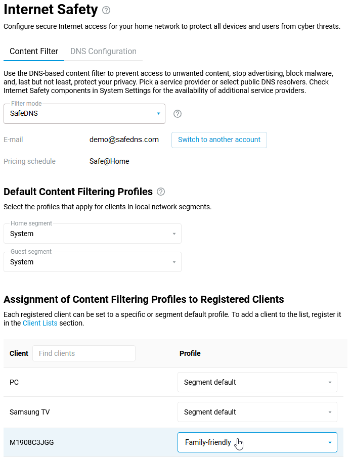

    In addition to schedules, we recommend enabling internet filters (ex. SafeDNS or NextDNS) to restrict access to dangerous sites and resources for adults. You can enable the Internet filter separately for each device in the home network by specifying the necessary policy.
    For example, the SafeDNS service allows you to set up filtering by categories (ban on visiting sites of certain topics), create 'Black' and 'White' access lists (block access to certain sites specified in the list, or grant access to certain sites only), keep statistics (list of visited and blocked sites), edit the blocking screen. We recommend you familiarize yourself with the full list of features of the Internet filter (and limitations of the free tariff) on the service's official site.
