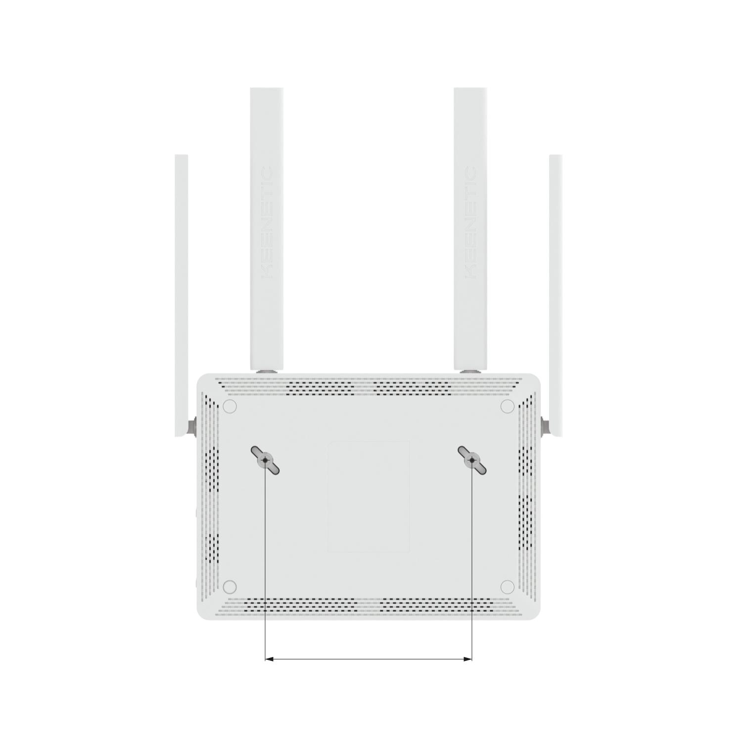

Router wall mounting information
All Keenetic router models have a wall mount option. There are two holes on the back of the case.
Mounting elements (self-tapping screws and wall plugs) are not included with the router.

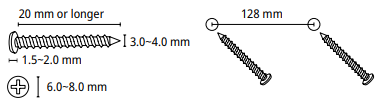

Information on mounting hole spacing and screw specifications:
Model
Titan (KN-1811)
Distance between holes
128 mm
Head diameter
6-8 mm
Head height
up to 1.5-2 mm
Thread
3-4 mm
Thread length
at least 20 mm
