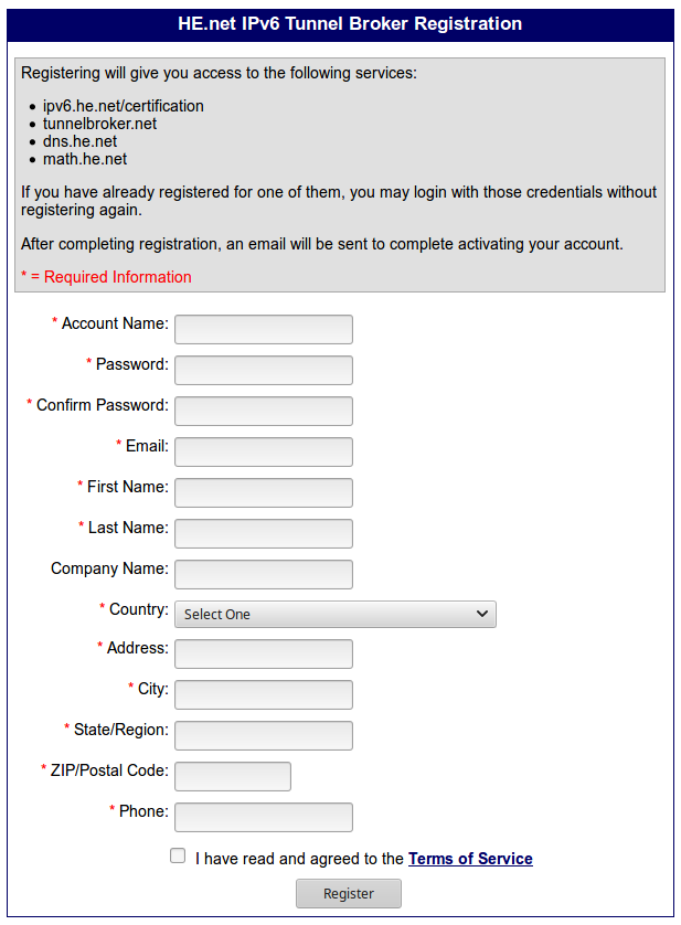

  2. Click the 'Register' button to enrol in the service.
  3. In the 'IPv6 Tunnel Broker Registration' window, enter the required information and click the 'Register' button.

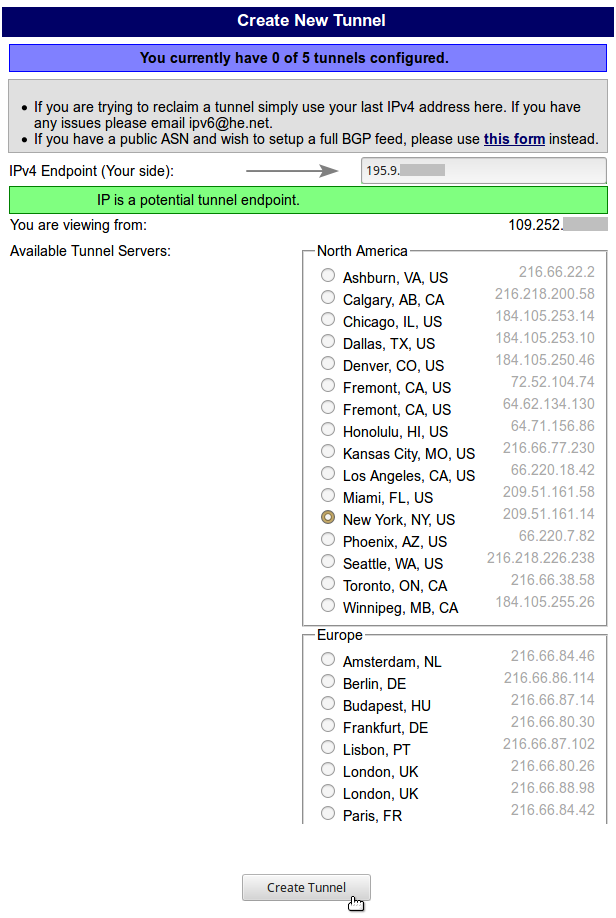

  4. To create a tunnel, click on the 'Create Regular Tunnel' link.
  5. In the 'Create New Tunnel' window, enter the static public IP address of the Keenetic in the 'IPv4 Endpoint (Your side)' field. You can check it in the web interface on the 'System dashboard' page.
  6. In the 'Available Tunnel Servers' table, select the tunnel server. You can choose the server closest to you by territory or keep the one automatically selected. Press the 'Create Tunnel' button to continue.

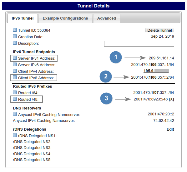

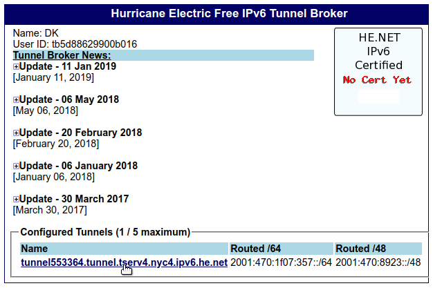

  7. Then, in the 'Configured Tunnels' section, click on the link of the created tunnel for detailed information about the IPv6 tunnel.
  8. The 'Tunnel Details' window on the IPv6 tab provides all the necessary information to configure an IPv6 tunnel over IPv4 in the Keenetic.
  9. 'Routed /48' does not immediately display prefix information. To get the prefix, press 'Assign'.
    You'll need the following information:
    • Server IPv4 Address
    • Client IPv6 Address
    • Routed /48 (IPv6 prefix)

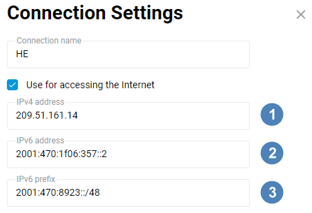

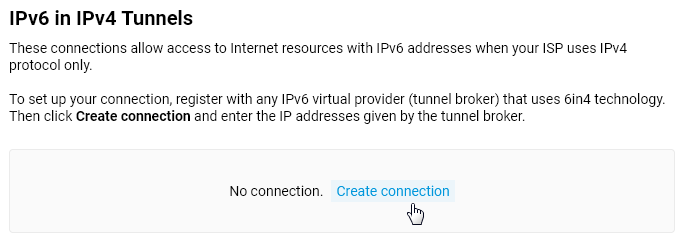

  11. Then go to the 'Other Connections' page, and in the 'IPv6 in IPv4 Tunnels' section, click 'Create connection'.
  12. In the 'Connection Settings' window, be sure to enable the 'Use for accessing the Internet' option. In the 'Connection name' field, specify any name to describe the connection. In the 'IPv4 address' field, you should enter the server address for connection (specified in the broker's control panel in 'Server IPv4 Address'). In the 'IPv6 address' field, insert the client address specified in the control panel in 'Client IPv6 Address' (add the address without the /64 prefix). And in the 'IPv6 prefix' field, insert the address from 'Routed /48'.
    Click 'Save' to save the router configuration.

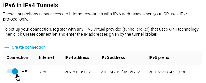

  13. On the 'Other Connections' page, to activate the tunnel, set the switch to the 'On' state.
    Застереження
    Starting with KeeneticOS 4.0, changes have been made to the implementation of IPv6 over IPv4 connections. Now, for this type of tunnel to work, it is necessary to raise the priority of the IPv6 connection on the 'Policy Configuration' tab, 'Connection priorities' page.

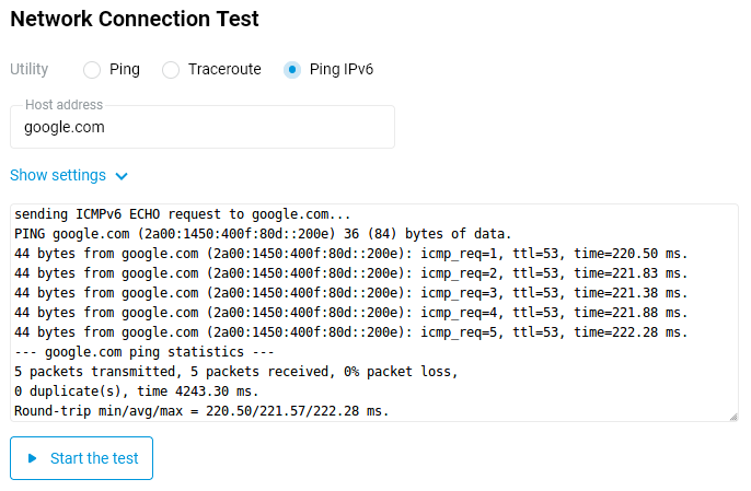

  14. To check the connection, go to the 'Diagnostics' page; in the section 'Network Connection Test', put the switch to 'Ping IPv6' and click 'Start the test'.
    If you successfully connect to a tunnel broker, the ping results must have no packets lost (0% packet loss). All packets must be sent (5 packets transmitted) to the host, and the host will reply (5 packets received).
