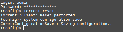

  1. To reset the settings, run the following commands from the command-line interface (CLI) of the router:
    (config)> torrent reset
    Once the above commands are executed, the configuration file settings.json will reset to factory settings.
    Also, the Default path to download torrents, Use incomplete directory, Language and other parameters configured in the Transmission web interface in the Config menu will be reset to default settings.
    After the reset, you will need to reconfigure Transmission and try it again.

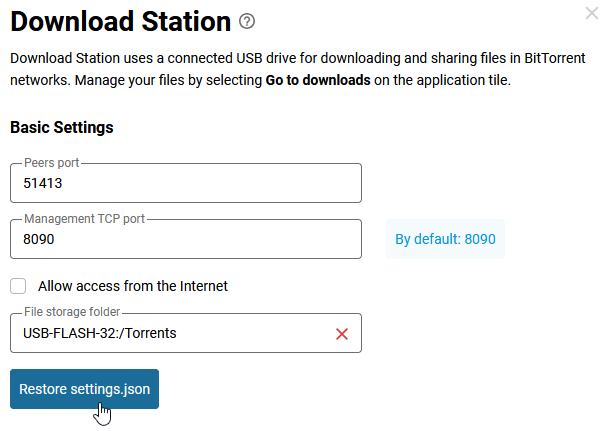

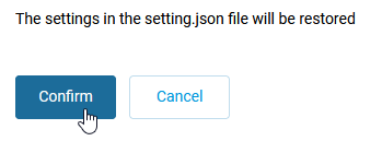

  2. In the Keenetic router web interface you can restore the settings.json configuration file to factory settings.
    To do this, go to the Applications page, click on Download Station and then in the window that appears, click on Restore settings.json button.

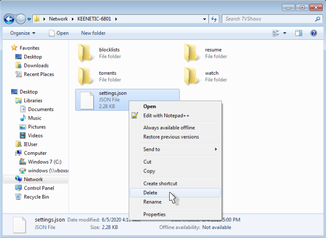

  3. Connect to the USB drive over the network (using Explorer or File Manager).
    Find the configuration file settings.json on it and delete it (in some cases, you may also need to delete dht.dat and stats.json files).
