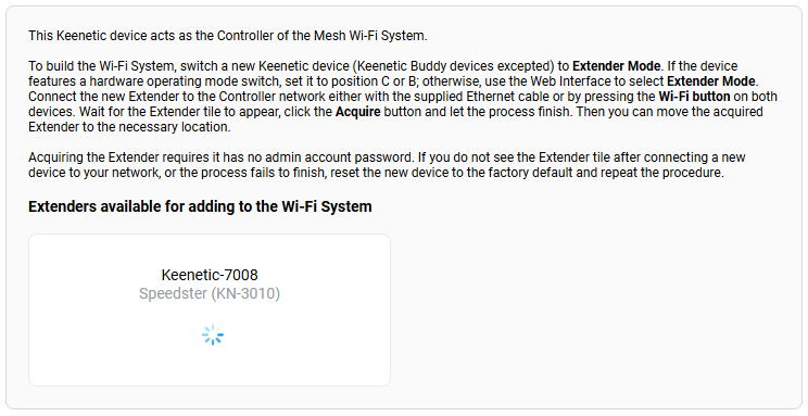

The Сontroller function is to be configured in the web configurator on the Mesh Wi-Fi System page. Once connected, the Extender will appear on the Devices tab in the Nodes available for adding to the Wi-Fi system list.
Before adding a new device to the Wi-Fi system, perform a factory reset on the Extender using the Reset button on the device's body.
The Controller will automatically detect the version of the Extender operating system and, if there is an update, will install the latest version of the device operating system. Click the 'Acquire' button to add the Extender to the Wi-Fi System. Wait for the process to complete.
After a capture, the device will appear in the list of Extenders.

If for some reason, the Extender does not appear in the list of available to add or is not captured in the Wi-Fi System, we recommend that you perform a factory reset on it and then reconnect and catch.

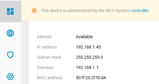

After adding Extender to the Wi-Fi System, you can access its web interface. Click on the Extender's IP address link.
When connecting to the Extender interface, use the administrator account password set on the Controller.
You can only use the built-in administrator account to manage the Wi-Fi System — admin.
Do not disable access to the router's web interface for this account under Users and access.
When you connect to the web interface of the Extender, you will see the message This device is administered by the Wi-Fi System controller.
On the Extender, the basic wireless network settings — Network name (SSID), Network protection (security protocol), Password (security key), seamless roaming settings, number of the wireless channel (if the Extender is connected by Mesh Wi-Fi technology), IP parameters, access control lists (White / Black) will not be available for editing. They can be changed only on the Wi-Fi System Controller (Main Router).
On the Mesh Wi-Fi System page, the Devices tab displays all Extenders - new, available for addition, and previously captured, already part of the Wi-Fi System.
