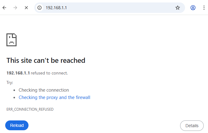

Question: Access to the Keenetic's web interface at 192.168.1.1 and my.keenetic.net has stopped working. An ERR_CONNECTION_REFUSED error appears in the browser.
At the same time, the Internet and local network through the router work.
