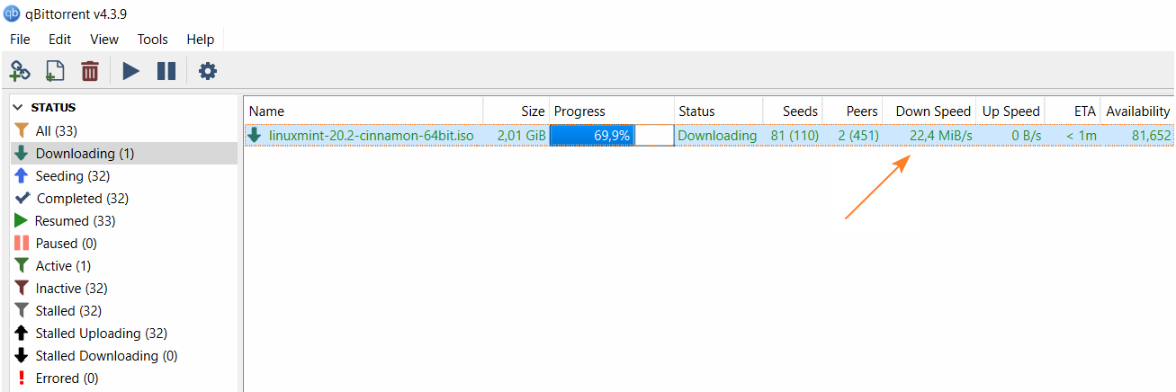

  6. Check the Download speed on connected interfaces in the web interface on the System Dashboard.
    Channel rate of Main connection and Backup connection up to 100 Mbit/s = 12.5 Mbytes/s.
    Start downloading the file and in the torrent client we see that the download speed is summed up from two Internet channels. In our example we get the speed up to 179.2 Mbit/s = 22.4 Mbytes/s. The download speed is summed from two profiles.
