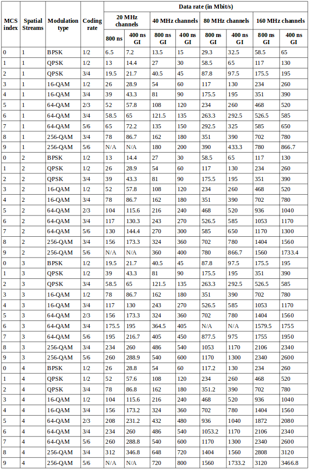

Below is a table of the maximum data rates of 802.11ac, depending on various parameters: modulation type, coding rate, the number of spatial streams, channel width (20/40/80/160 MHz).
For example, we can calculate the maximum theoretical speed that the 802.11ac standard can provide.
On a single spatial stream, with a channel width of 160 MHz and 256-QAM modulation, the maximum theoretical speed is 867 Mbps. The 802.11ac standard optionally* supports 8 spatial streams. Multiply 867 Mbps by 8, and you get a speed value of about 7 Gbps, which is well above the maximum theoretical speed on 802.11n (it is 600 Mbps using 4 spatial streams, each of which operates at 150 Mbps).

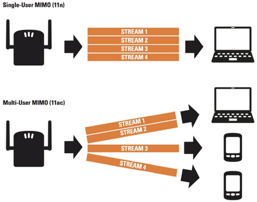

Support for MU-MIMO technology
The MIMO technology implemented in the 802.11n standard enables simultaneous reception/transmission of data between devices in the network. But at a given point in time, only one device can receive and send data while others are waiting their turn. The 802.11ac standard significantly improves this situation. Multi-User Multiple-Input, Multiple-Output (MU-MIMO) technology has been implemented within the standard.
MU-MIMO creates a multithreaded transmission channel in which other devices do not wait their turn.
MU-MIMO-enabled devices can simultaneously transmit up to four data streams (up to four clients). This enables more efficient use of the wireless network and reduces the latency that occurs when the number of clients in the network increases significantly.
