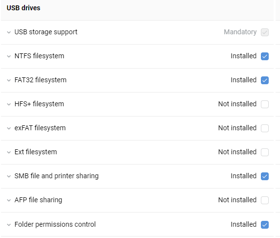

  1. Before connecting the USB flash drive to the Internet hub, ensure that the system components required to work with the USB flash drive are installed on the device. This can be done on the 'General System Settings' page in the 'KeeneticOS Update and Component Options' section by clicking 'Component options'.
    In particular, when connecting a USB drive with an NTFS file system, the NTFS filesystem component must be installed, and when connecting a USB drive with a FAT32 file system, the 'FAT32 filesystem' component must be installed.
    'Folder permissions control' component allows you to set permissions for individual directories located on the USB drive, while the 'SMB file and printer sharing' component provides access to USB drives and printers for PCs with Windows OS.

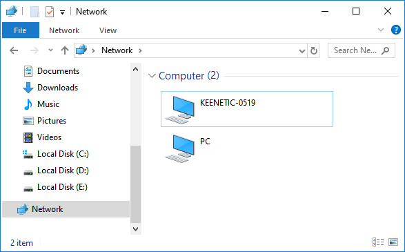

  4. Below is an example of configuring the network access to USB storage from Windows. Use 'Run' or open the 'Explorer' file manager. Type the local IP address of the Keenetic in the address bar,  with \\ in the beginning (in our example, it's \\192.168.1.1). You can use network name of the Keenetic, example \\Keenetic-0519.
    If the router is in the same workgroup as other computers on your home network, you can access the USB drive through your 'Network Neighborhood' (Network).
    If you don't see the name of your router on your computer in the network, refer to the article What to do if the USB drive cannot be accessed over the network or the router does not appear on the Windows network.
