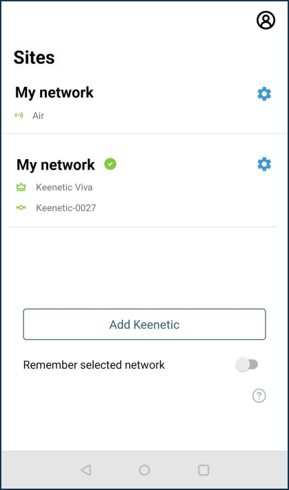

After adding your router to the app, you will have access to its settings.
The start screen will show you all the routers you have added for management. Tap on the device whose settings you want to connect to.

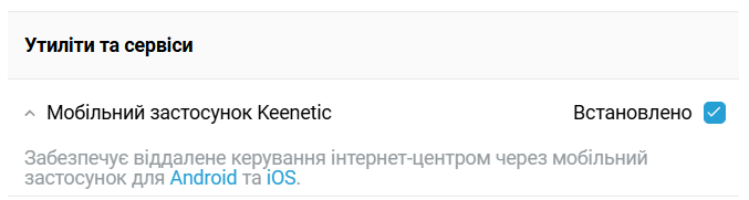

Make sure that the system component Keenetic mobile application is installed. You can do this in the web interface on the System Settings page in the KeeneticOS Update and Component Options section by clicking on Component options.

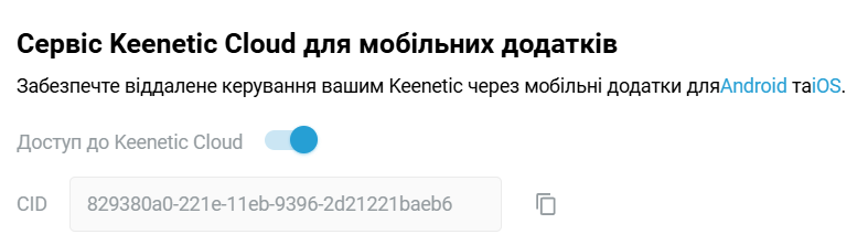

Make sure that Keenetic Cloud access is enabled.
This setting can be found in the Keenetic Cloud Service for Mobile Applications menu on the General System Settings page.
