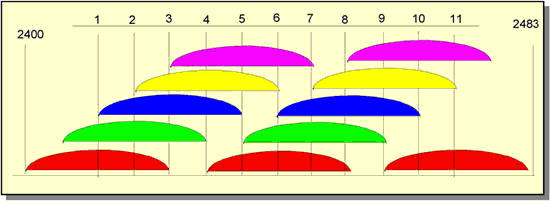

    In the 2.4 GHz frequency band, 11 or 13 channels (20 MHz (802.11b/g/n) or 40 MHz (IEEE 802.11n) wide) are available for wireless networks at 5 MHz intervals. A wireless device that uses one of the frequency channels creates significant interference with adjacent channels. For example, if an access point uses channel 6, it will heavily interfere with channels 5 and 7 and will interfere less with channels 4 and 8. Their carrier frequencies must be separated by 25 MHz (5 interchannel intervals) to avoid channel interference.
    You can see the spectra of 11 channels in the picture. The color-coding indicates groups of non-intersecting channels — [1,6,11], [2,7], [3,8], [4,9], [5,10]. Wireless networks within the same coverage area are recommended to be configured for non-intersecting channels with less interference* and fewer collisions (conflicts). For the 802.11n protocol, the non-intersecting channels are 1, 6, and 11 (for a 20 MHz channel width), with 40 MHz channel width, they are channels 3 and 11.
    * Interference is the signal transmitted by other devices on the same channel (or close to it) that your access point is operating. Such devices can be part of your Wi-Fi network or not.
