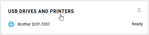

  3. On the 'System dashboard' page, ensure that the connected printer is detected and visible in the 'USB drives and printers' information panel. The printer status must be 'Ready'.
    In this example, we connect the Brother DCP-7057 printer.
    Click on the link 'USB drives and printers' to go to the 'Applications' page.

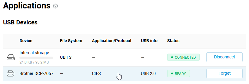

  4. On the 'USB Devices' section, you can manage the connected printers. Clicking on the connected printer will take you to the printer's advanced settings.
    By default, the printer is connected via the CIFS protocol, and the bidirectional mode is disabled.

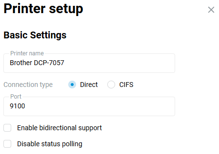

  5. As mentioned above, CIFS is the default printer connection, but if your printer fails to print, change the connection type to 'Direct'. For details on setting up this type of connection, please refer to the 'Connecting a printer in Direct mode' manual.

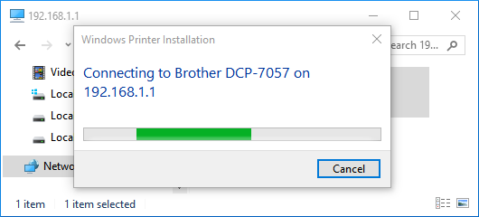

  6. Now in Windows, in the file manager address bar, enter the local IP address of the router or its network name, starting with \\ (in our example, it is \\192.168.1.1), and make sure that the printer can be seen there.
    The printer will only be visible when using a CIFS connection type. Click on the printer icon.
    Install the printer driver during the connection procedure.
    If you see an error when you click on the printer icon, you will most likely need to use the 'Direct' connection type to operate the printer. Please refer to the 'Connecting a printer in Direct mode' article.

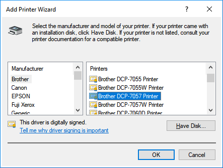

    Select a printer from the list. If the required printer is not on the list, install the driver from a disk. Normally, printers come with an installation CD. If you do not have the manufacturer's installation CD, you can download a driver for your printer from the Internet (for example, from the manufacturer's website). Download the driver, unpack it to a folder on your hard drive and then specify the path to the driver.

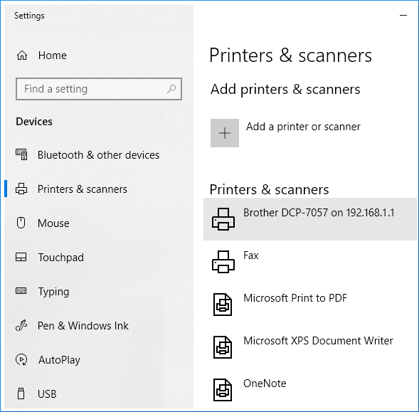

    Then go to Windows Settings. Ensure that the printer has been installed in the 'Devices' menu in the 'Printers and scanners' section.
