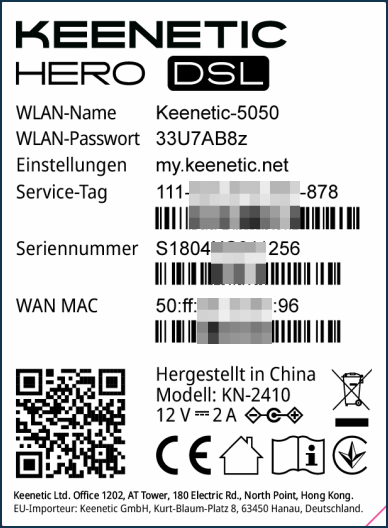

The Wi-Fi network name and password for the connection can be found on the device's bottom label. For example:

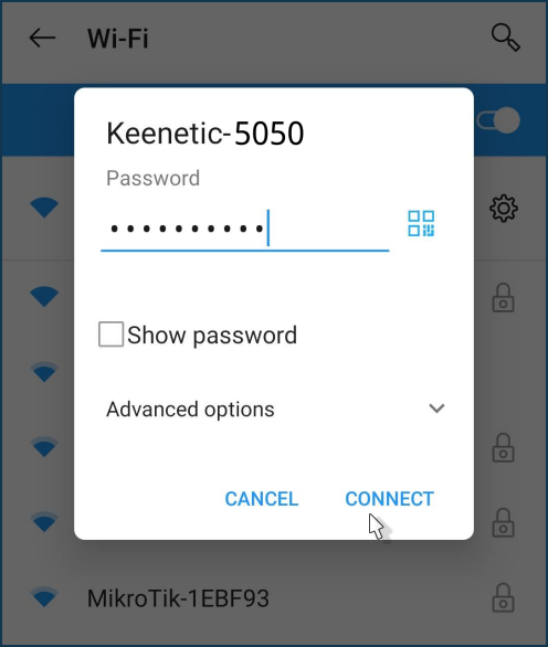

Switch on the Wi-Fi network on your mobile device, and in the list of available networks, find your network whose name is on the label and click on it. In our example, this is the
Keenetic-5050
network.Enter the Wi-Fi password to connect to the network; this is also shown on the label, and tap 'Connect'.

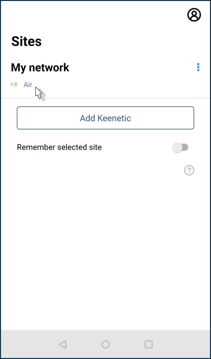

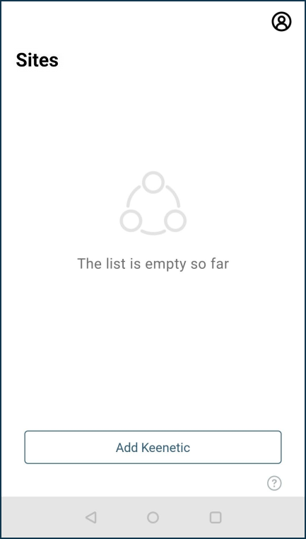

Launch the app, log in to your Keenetic Account or create one if you don't have it. Then, on the Sites screen, tap 'Add Keenetic'.
If you are connected to your router's network, the app automatically searches it for Keenetic devices.
Tap on the detected device.
