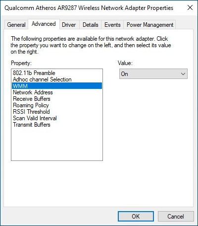

  7. Make sure that the access point and adapter support and enable WMM mode
    WMM (Wi-Fi Multimedia) mode must be enabled for speeds above 54 Mbps.
    The 802.11n specification requires devices to support the 802.11e standard (QoS for improved wireless performance) to use the High Throughput mode, i.e. speeds above 54 Mbps.
    WMM mode support is required for devices that are certified to use the 802.11n standard. We recommend enabling WMM mode by default in all certified Wi-Fi devices (access points, wireless routers, adapters).
    Please note that WMM mode should be enabled on both the access point and wireless adapter.
    WMM mode in the settings of different adapters can be called differently: WMM, Multimedia environment, WMM Capable, etc.

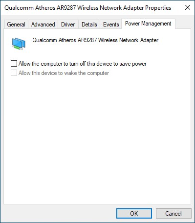

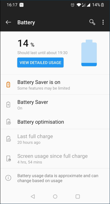

  13. Turn off power-saving mode
    Low Wi-Fi connection speed can be observed in some mobile devices with power-saving mode activated (sleep mode). It can affect the operation of the Wi-Fi client's wireless adapter. Manually turn off this mode to verify the connection. On some devices, the power-saving mode is automatically activated when the battery charge level is set to a specific limit (for example, when the charge is below 20% or 15%). If you do not know how to turn off the power-saving mode in the operating system settings, we recommend that you make sure that the battery level does not fall below a certain level (in some systems, the battery indicator in the status bar changes its colour to yellow).
    On a Windows laptop, in the wireless adapter properties on the 'Power Management' tab, try disabling the 'Allow the computer to turn off this device to save power' option. For example:
    You may also experience low Wi-Fi speeds after your device leaves sleep mode. In this case, try to turn the device off (shut down the system) and turn it back on again.
