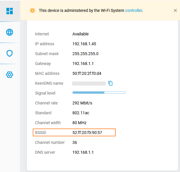

Answer: Yes, it is possible. If you want the far-end extender to connect only to the near-end extender, not to the Main Router, you can specify the BBSID (Wi-Fi MAC address) of the near-end extender. You can see it on the System dashboard page of the far-end extender when it is connected to the near-end extender. In our example 52:ff:20:f5:90:57 is the BSSID of the near-end extender:

In our example 52:ff:20:f5:90:57 is the BSSID of the near-end extender to be connected to.
