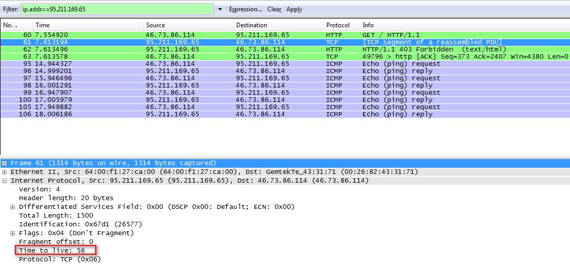

When connecting directly to the ISP, the TTL is 56 (the dump is taken from the network interface of a PC connected directly to the ISP):

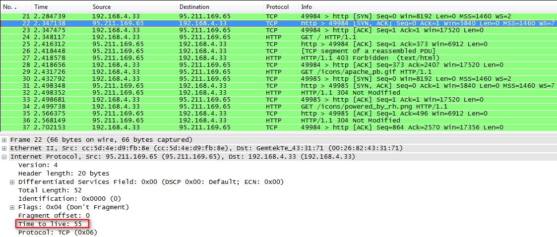

When you connect this PC through the router, this value will decrease and become 55 (the dump is taken from the network interface of the PC connected to the router):
