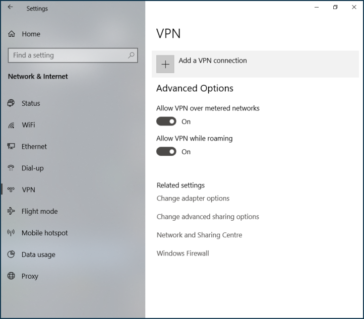

Right-click on the 'Start' button, select 'Network Connections' and on the screen that appears, 'VPN'.
Select 'Add a VPN connection'.

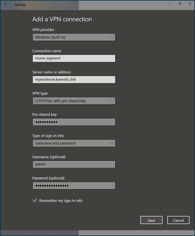

Select 'Windows (built-in)' as the VPN service provider in the connection settings. Enter a name for the connection, for example, 'Home segment'. Enter the domain name or IP address of your Keenetic in our example — 'myworknow.keenetic.link'. Select the VPN type — 'L2TP/IPSec with pre-shared key'. Enter the pre-shared key for IPSec that you created and recorded during the configuration of the Keenetic VPN server. Next, enter the username (that is allowed to connect to the VPN) and its password. Click the 'Save' button.

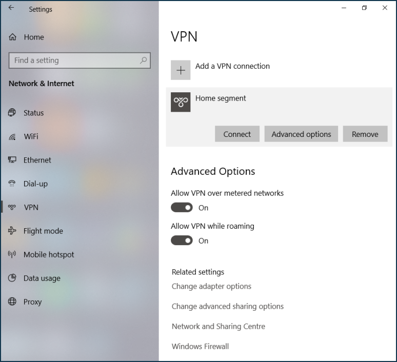

To establish a connection, click the 'Connect' button.
The connection is established.
