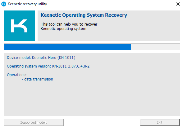

To run the utility, first, unzip the zip archive and then run the krutil.exe file.
Follow the steps below:
  1. Switch off the router and disconnect all network cables from it.
  2. Connect your computer with an Ethernet cable to one of the Home Network ports on the router.
  3. Press the Reset button on the router and turn on the router's power while holding it down.
  4. Release the Reset button when the Status LED on the router starts blinking.
The recovery process will start automatically after a few seconds.
