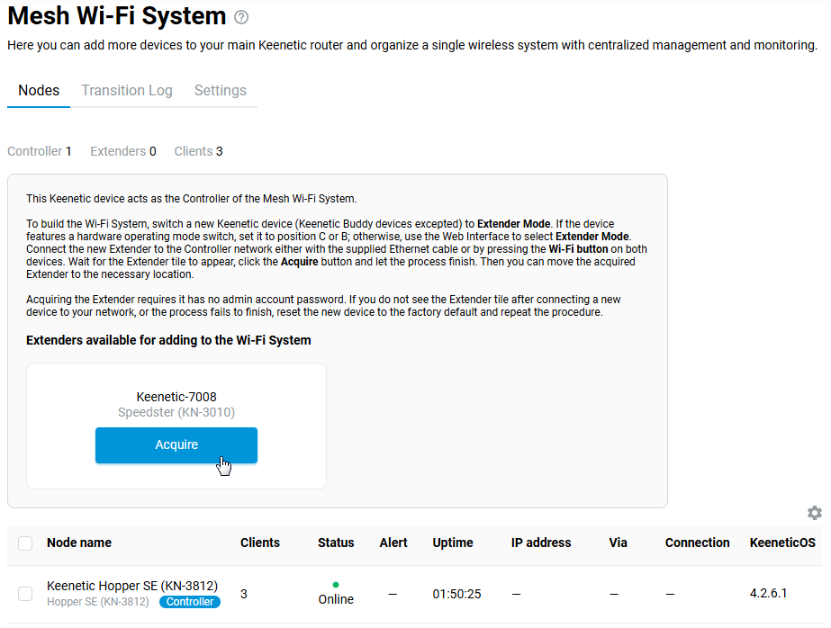

  5. Open a web browser, go to my.keenetic.net , log in to the Main Router's web interface. Open the Mesh Wi-Fi System page and click Acquire to add the Extender to your Wi-Fi System.
    At the time of integration, the operating system of the Extender may be updated.
    Wait until the process is complete.

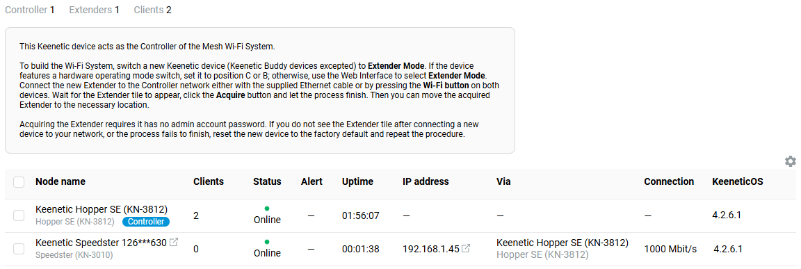

  5. Open a web browser, go to my.keenetic.net, log in to the Main Router's web interface. Select the Wi-Fi System section and click Acquire to add the Extender to your Wi-Fi System.
  6. Move the Extender to the location in your home to increase Wi-Fi coverage. If the Extender is successfully connected to the Wi-Fi System, the indicator internet_led.png on the Extender will illuminate.
