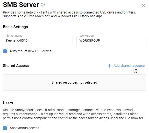

    Click on USB drives and printers to go to the Applications page. Here you will see the SMB Server panel. SMB server is enabled by default. The operating system of the router supports CIFS/SMB (SMB v1/2/3) protocols. Click SMB Server to configure the file server and to share folders.
  3. In the Basic Settings option, Auto-mount new USB drives is enabled by default. This means that the newly-plugged drive will be automatically added to the system. You can change the server's name in the Server name field, identifying the router in a local network (NetBIOS name). If you want the router to be visible in Network Neighborhood, you need to specify the group name to which all other PCs belong in the Workgroup field.

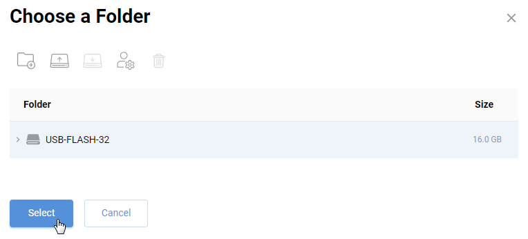

    To add and configure a shared folder, click on Add shared resource. A window opens with a built-in file browser, where you have to specify a certain folder on the USB drive, which will be shared, and then click the Select button. In our example, we selected the root directory to provide access to all folders on the drive.

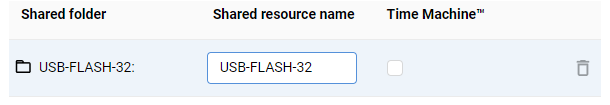

    After selecting the shared folder, you need to go back to the SMB server page. The name of the shared folder will be displayed automatically in the Shared resource name block, but you can set its name manually.
    The Anonymous access option (access without authentication) is enabled by default in the Users section. Access to the file server from computers and mobile devices running Android, Microsoft Windows, Apple OS X, and iOS is open by default to all users of the home network without authentication. You can change this setting and add the Folder permission control component to restrict users' access to folders. Additional info you can find in the article Folder permission control on a USB drive.
    This completes the router setup.
