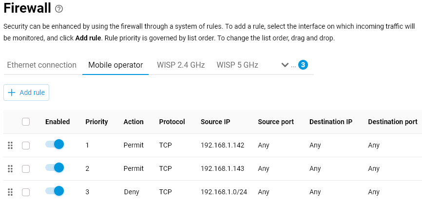

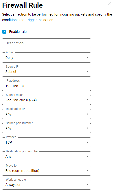

In the firewall settings, we need to create rules for the backup interface. In our example, a built-in 5G/4G/3G modem is used as the backup connection, but it could also be a USB modem. When connecting a 5G/4G/3G modem to the router, an interface of the UsbLte0 type is created by default (the name of the interface may vary depending on the type of modem being connected). On this interface, we will create three rules: two to grant access to client devices with IP addresses 192.168.1.142 and 192.168.1.143, and one rule to deny access to all other clients.

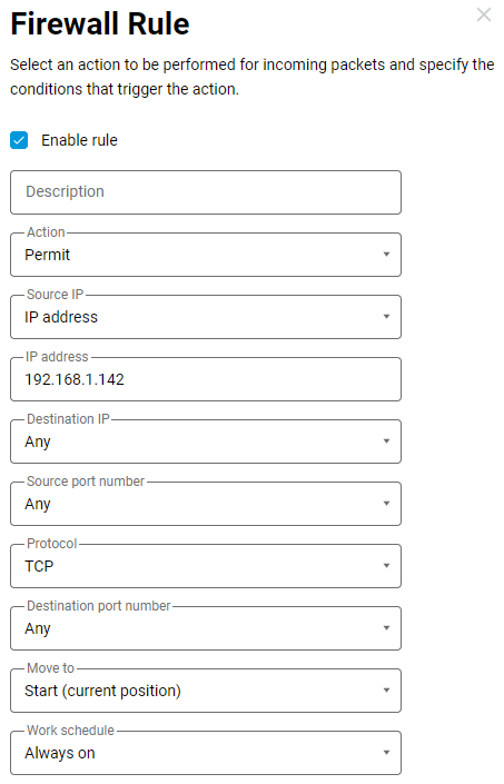

First, let's create an allow rule in which we specify the source IP address (the IP address of the client that will be allowed access) and the TCP protocol type.
If you want to allow access to multiple network clients, create similar rules for them too.
Then we create a blocking rule, specifying the subnet (192.168.1.0 with a mask of 255.255.255.0) as the source IP address and TCP as the protocol type.

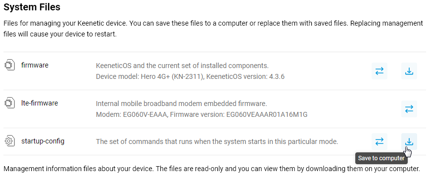

1.1 Go to the General System Settings page in the System Files section. Find the startup-config file. This is a text file with user settings that are executed when the router starts up. Save it on your computer for further editing.
Click on the startup-config file entry and then click Save to computer. The file will be downloaded by your web browser. If a file save window appears, specify the location (the folder where the file will be saved) and click Save or OK.

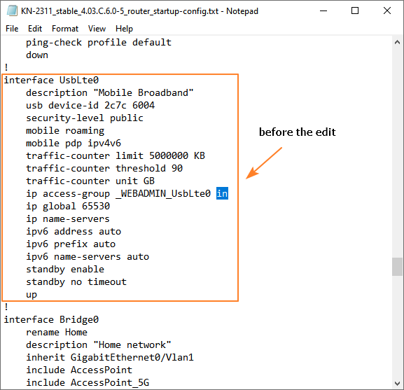

1.2 Open the startup-config configuration file in any text editor, such as Notepad. Then find the backup provider interface configuration section (in our example, this is UsbLte0) and replace the word in with out in the ip access-group line. Then save the file.
In our example, in the line
 ip access-group _WEBADMIN_UsbLte0 in
the word in was replaced with out, resulting in the following line:
 ip access-group _WEBADMIN_UsbLte0 out
Be sure to save the changes to the file.

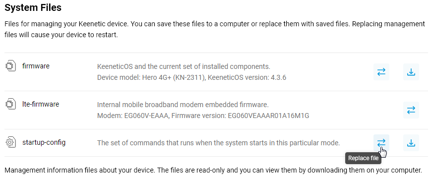

1.3 Now the edited startup-config system file needs to be written (uploaded) to the router. To do this, click the Replace file button and specify the path to the edited configuration file.
After uploading the startup-config file, the router will automatically reboot. Wait until the device is fully powered up.

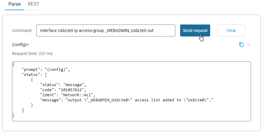

Connect to the command-line interface or webcli. First, execute the command:
no interface UsbLte0 ip access-group _WEBADMIN_UsbLte0 in
Then run the command:
interface UsbLte0 ip access-group _WEBADMIN_UsbLte0 out
The in and out parameter specifies the direction of traffic to which the ACL will be applied.
in — apply filtering to incoming packets
out — apply filtering to outgoing packets
To solve our problem, we need to set up filtering for outgoing network packets on the backup interface.
