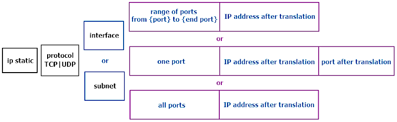

2. Syntax of the 'ip static' command
ip static [ <protocol>] ( <interface› | ( <address> <mask>) ) ( <port> through <end-port> (<to-address> | <to-host> | <to-interface>) | <port> (<to-address> | <to-host> | <to-interface>) [<to-port>] | <to-address> | <to-host> | <to-interface>)
The rule can work either for one of two protocols (tcp or udp) or for all protocols (including icmp). If the tcp or udp protocol type is not specified, then it is not possible to select a port number in the syntax.
