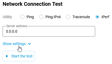

To use iPerf, you need to first install the iPerf3 system component on the device. This can be done on the General System Settings page in the KeeneticOS Update and Component Options by clicking Component options.
The iPerf utility settings will appear on the Diagnostics page in the Network Connection Test section. Select iPerf and click Show settings.
In the Server address field, enter the IP address of the public IPerf3 server that will be used for testing. You can find the addresses of public IPerf3 servers on the Internet.

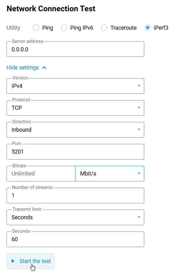

In the utility settings, you can also select the IP version (IPv4 / IPv6), protocol (TCP / UDP), traffic direction (Inbound — for testing incoming traffic / Outbound — for testing outgoing traffic), port number (default is 5201, we recommend not changing the default value), bitrate, number of streams (default is 1, we recommend not changing the default value), data transfer limit (seconds / bytes).
To run the test, click the Start the test button. In this case, the iPerf3 client on the router will connect to the specified iPerf3 server, and then data will be transferred between them to measure the bandwidth of the Internet channel.
For more accurate results, we recommend using a server located in your region.
Use TCP* protocol testing without limiting the maximum speed, setting the test time to at least 10 seconds (usually 10 to 30 seconds is sufficient to measure the bandwidth of the Internet channel).
*Do not use the UDP protocol when measuring the internet connection speed from a router. Unlike TCP, UDP does not use packet delivery control or transmission speed control algorithms, and it behaves differently on the network.
During testing, a fairly large amount of data is transmitted or received. Keep this in mind when using a tariff with a traffic limit. In this case, you can set a data transfer limit.

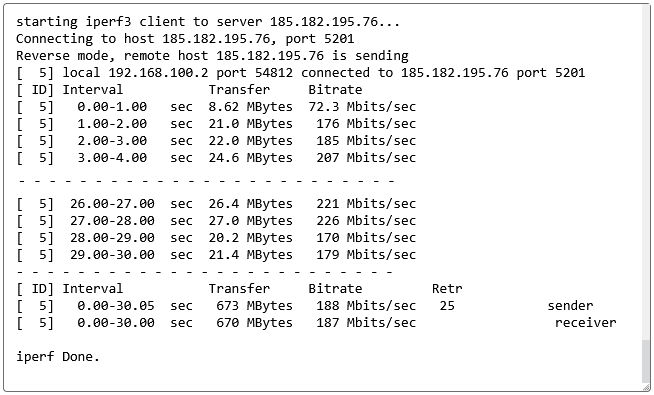

Upon completion of the test, the connection will be terminated, and the test results will be displayed. For example:
The average internet connection speed obtained during the test will be displayed in the Bitrate field in Mbit/s. In our example, the internet channel bandwidth measurement was 188 Mbit/s on a 200 Mbit/s tariff.
